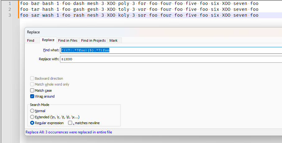

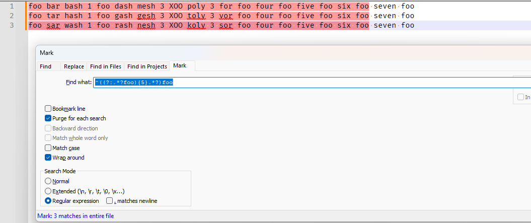

        PeterJones @Fra
        @Fra said in Replace 2nd occurrence in string per line, then nth occurrence Npp v8.8.1:
        ^(.*?foo.*?foo.*?)foo
        That regex behaves the same as ^((?:.*?foo){2}.*?)foo
        so if you want to keep the first 5, and do the replacement on the N+1=6th, it would be ^((?:.*?foo){5}.*?)foo

            PeterJones @Fra
            Nice too the indexing starts from zero:
            Personally, I would say that’s a dangerous way to think about it, and it will confuse you as you learn more about Boost regex and capture groups.
            The {ℕ} “multiplying operator”, as described in the documentation, is saying there must be ℕ matches of whatever came before the operator: so, in the case of my regex, it is saying "there must be ℕ occurrences of something followed by foo, and all ℕ of those are put into capture group #1; group#1 must be followed by the (ℕ+1)th occurrence of foo, and it’s only that last that is replaced (because you included $1 in the replacement, which means the contents of group#1.
            The problem with thinking of 0-indexing in this case is because it will confuse you as you learn more about capture groups. Because capture groups are numbered starting at 1, so (a)(b)(c) will put a into group#1, b into group#2, and c in group#3 – a replacement of $3$1$2 would be cab. Further, “group#1” (referenced as $0 in the replacement) is not one of the captured groups, but is, in fact, the entire match, so replacing with $3$1$2//$0 would give cab//abc. Then you’ll get yourself into trouble thinking that it’s 0-based, because it’s really and truly 1-based.

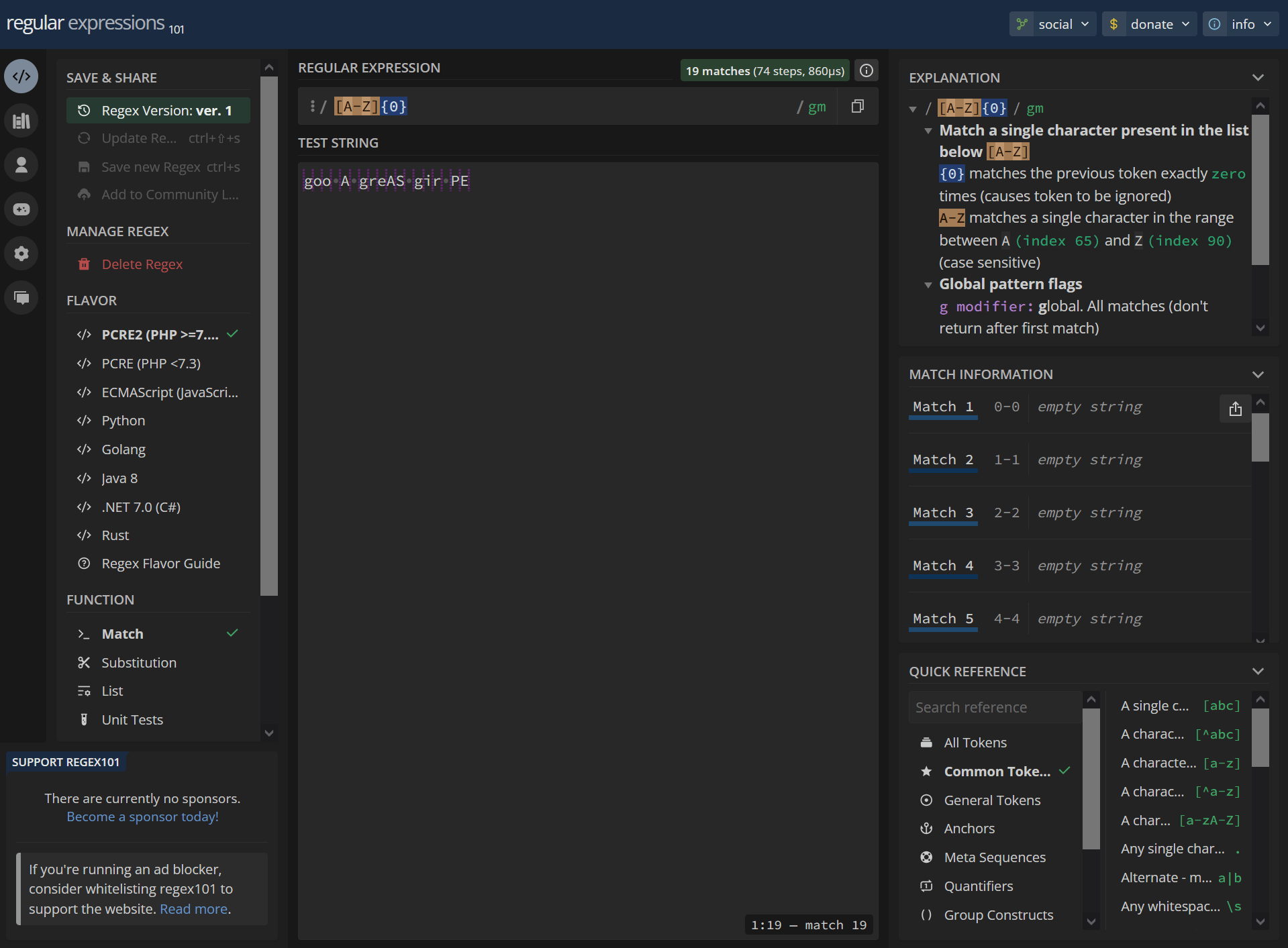

              For example:
              19 empty string matches:
              [A-Z]{0}
              goo A greAS gir PE
              https://regex101.com/r/dYnJmE/1
              [A-Z]{0}
              gm
              Match a single character present in the list below [A-Z]
              {0} matches the previous token exactly zero times (causes token to be ignored)
              A-Z matches a single character in the range between A (index 65) and Z (index 90) (case sensitive)
              Global pattern flags
              g modifier: global. All matches (don't return after first match)
              m modifier: multi line. Causes ^ and $ to match the begin/end of each line (not only begin/end of string)
              0-0	empty string

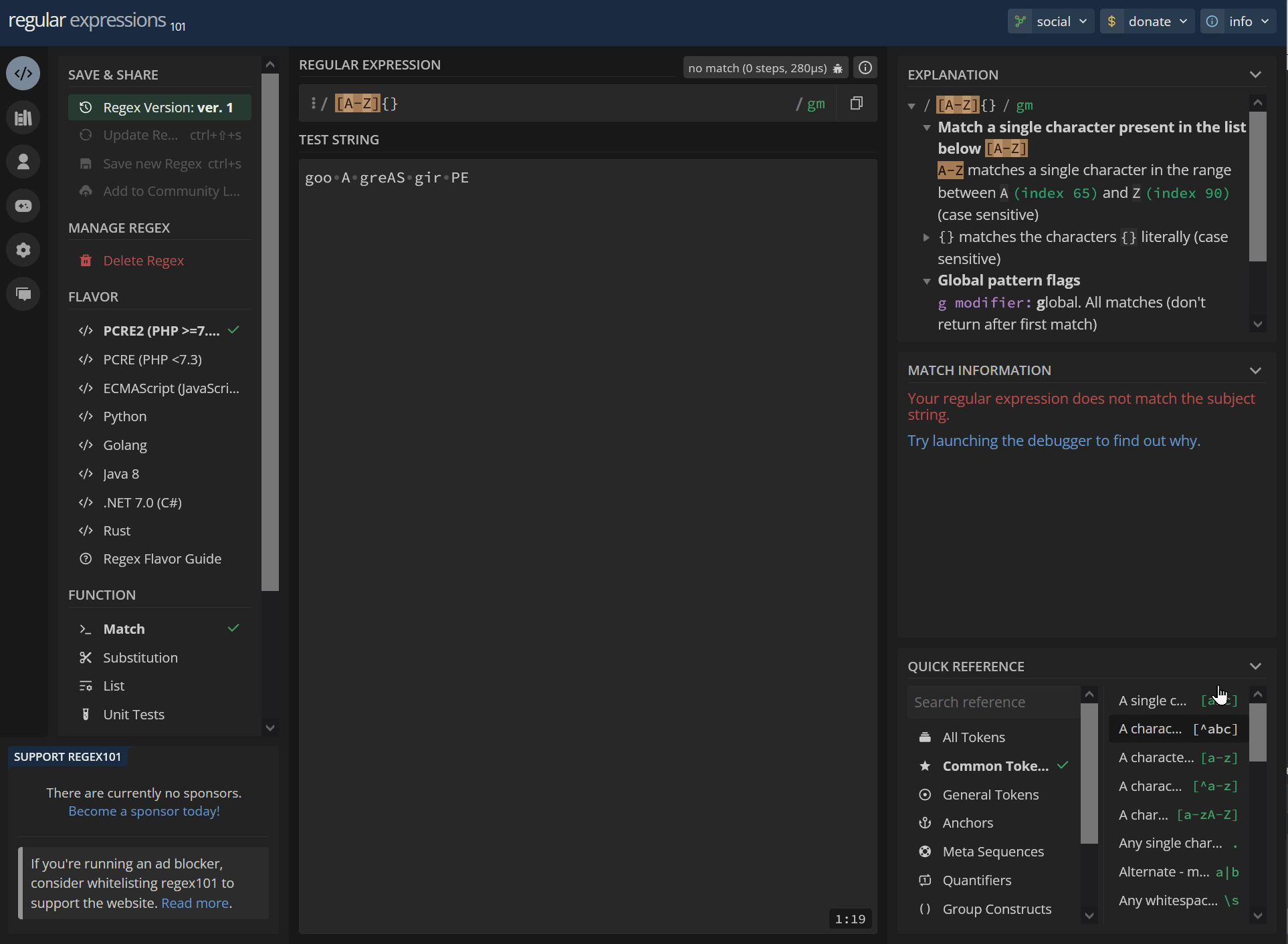

              No match/invalid:
              [A-Z]{}
              goo A greAS gir PE
              https://regex101.com/r/CtqQ0D/1
              [A-Z]{}
              gm
               matches the characters {} literally (case sensitive)
              Your regular expression does not match the subject string.

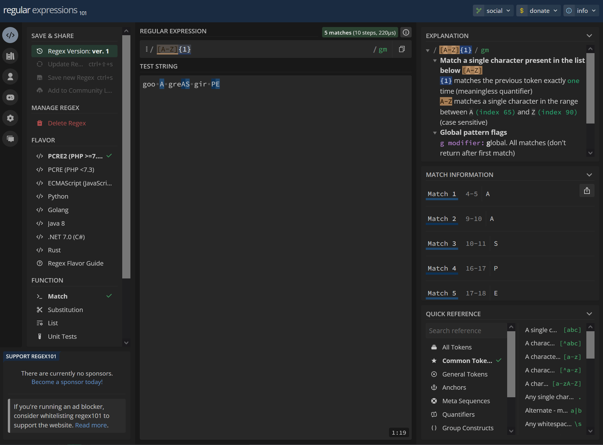

              5 matches:
              [A-Z]{1}
              goo A greAS gir PE
              https://regex101.com/r/MImsNL/1
              [A-Z]{1}
              gm
              {1} matches the previous token exactly one time (meaningless quantifier)
              4-5	A
              9-10	A
              10-11	S
              16-17	P
              17-18	E

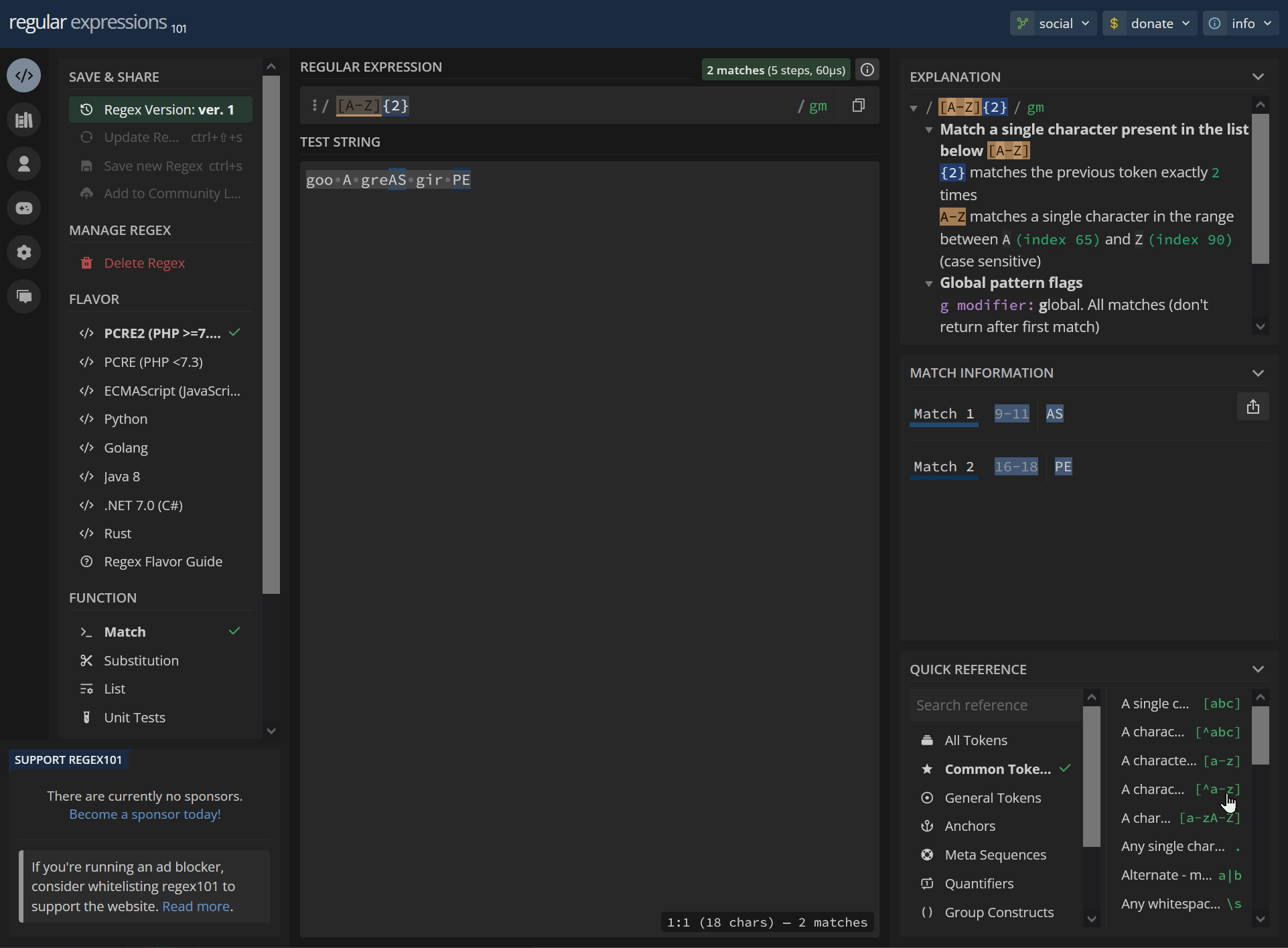

              2 matches:
              [A-Z]{2}
              goo A greAS gir PE
              https://regex101.com/r/p1WOWQ/1
              [A-Z]{2}
              gm
              {2} matches the previous token exactly 2 times
              9-11	AS
              16-18	PE
