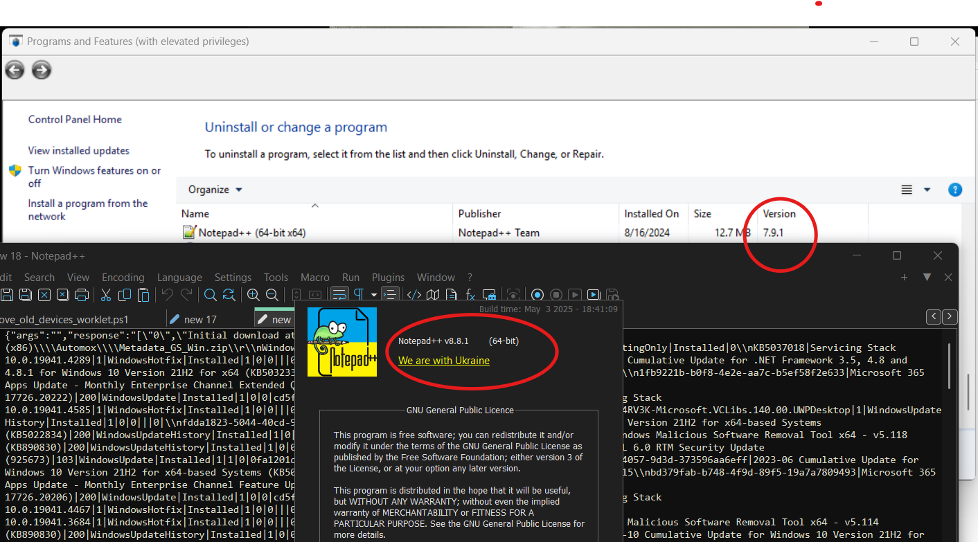

      8.8.1 is reporting to windows that it is 7.9.1, this is causing our patching agent to push the 8.8.1 update every single day to every single device. How do we fix this?

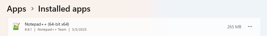

        I was originally going to guess that the installer doesn’t always update the right “bit” somewhere in MS Windows nightmarish labyrinth of settings… But when I look at my installed v8.8.1, the OS correctly tells me that I installed the updated Notepad++ on May 5:

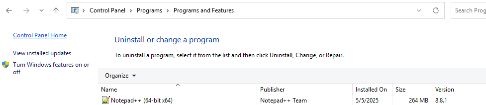

        same result in the old Control-Panel-based interface:

          @PeterJones we are using a 3rd party updating software call Automox, which runs the vendor installers for a bunch of different products silently

              @PeterJones apologies, this my first foray into this community, despite being a loyal user for almost 20 years, so i wasn’t sure how it worked
              I just downloaded and ran the installer for 8.8.1 and unfortunately the behavior hasn’t changed… i will give it a reboot later today and see if that helps at all
