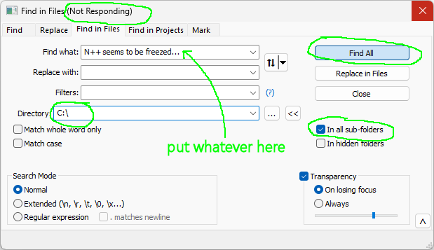

                Meanwhile only my guess - if you wait long enough, the N++ will start responding again. This all might be due to the design of the N++ FindInFiles func, which currently scales poorly when used on a large number of files (and using network here, with much slower access speed, could only exacerbate the problem). One can easily simulate such a ā€œN++ GUI-freezingā€ even on local files, e.g. try this:
                Details about the current sub-optimal ā€œtwo-stageā€ FindInFiles design causing the above (there is also a possible WM_TIMER GUI-fix mentioned but I never had time to really try it) :
                https://github.com/notepad-plus-plus/notepad-plus-plus/issues/13972#issuecomment-1767212918
