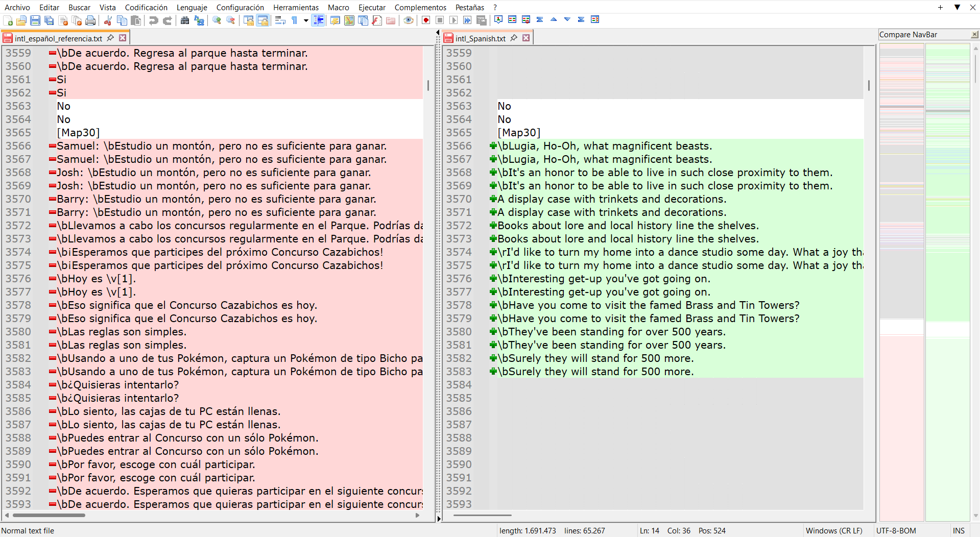

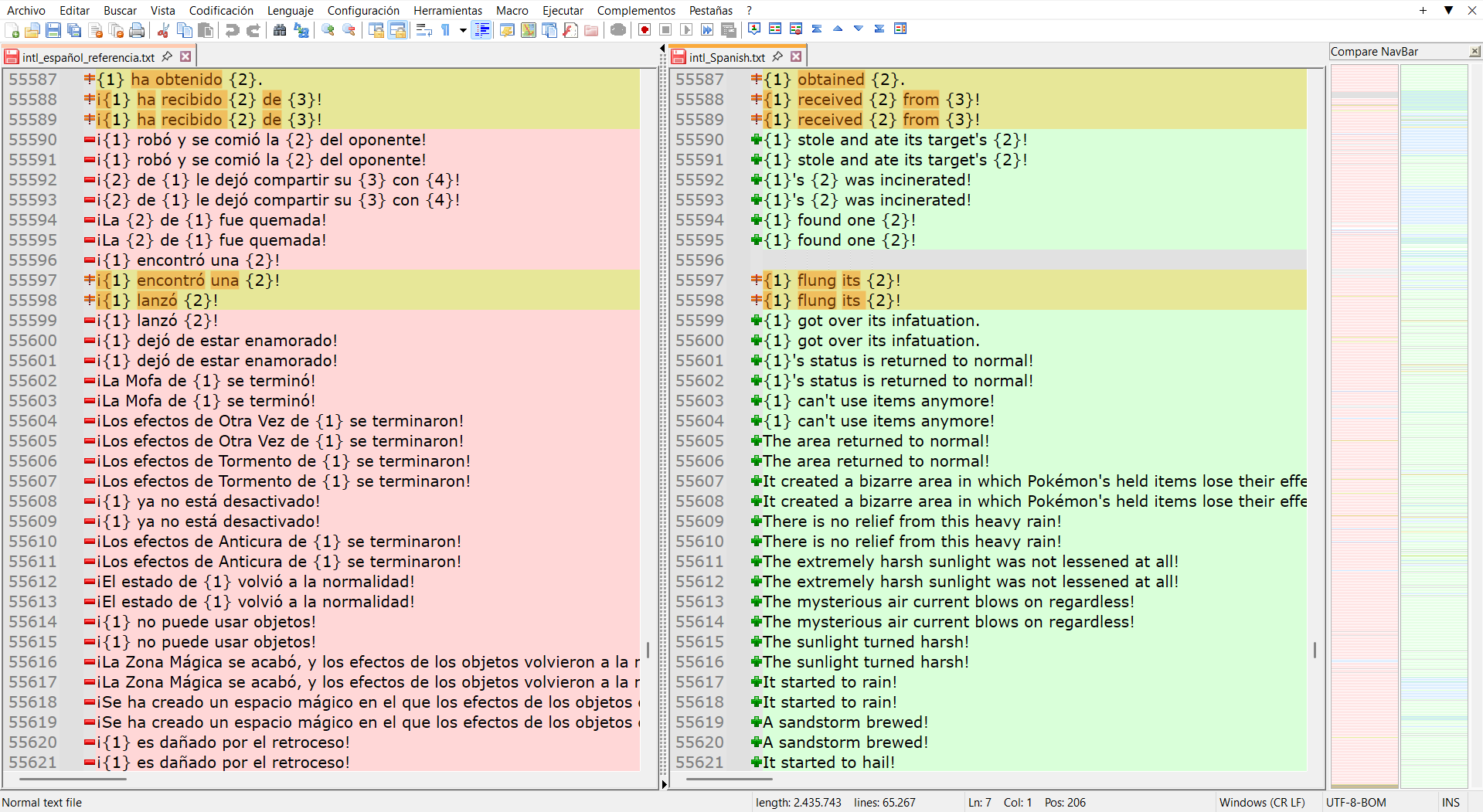

      Hello! So, I’m translating a really big file for a Pokémon RPG Maker game, and I’m using two files: one in Spanish and another one in English.
      The thing is, lots of the lines just need to be copypasted from one file to the other one, and double-clicking got old pretty fast. I’m trying to find a way of doing this as quick as possible to prevent burning myself out, but I haven’t found a good method of doing so.
      As you can see, the Spanish file is on the left and the English one on the right. I need to copy/translate the second lines of the English file and leave the first ones untouched, and I figured that I could double-click those lines on the Spanish file, pressing ctrl to select multiple ones, and doing the same thing on the right but pasting them.
      …But, as I wrote before, it’s just a pain.
      I found a program called “Meld”, and while it kind of does what I want, it’s a bit slow and it doesn’t replace just the second line, but both of them.
      The question is: is there a plugin that could help me do what I’m looking for? It’s my first time using Notepad++, so I’m a bit lost here.

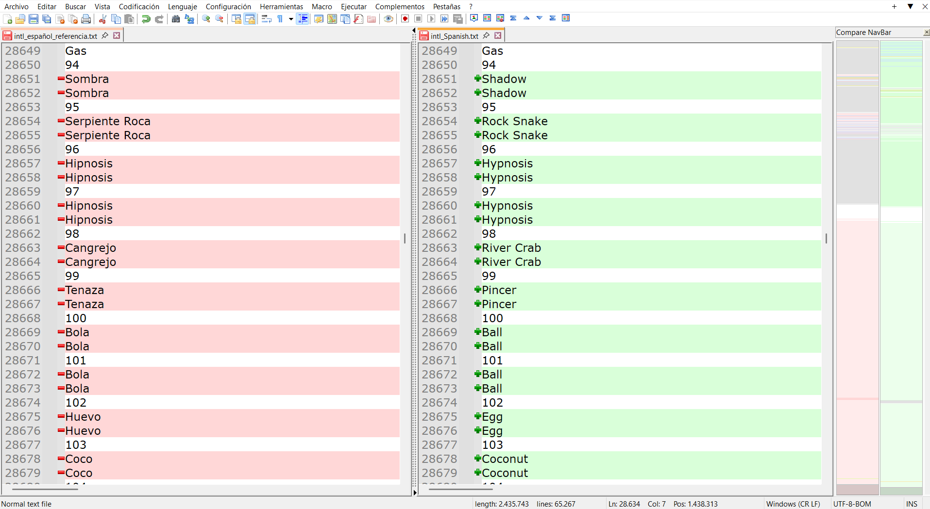

          @Mark-Olson I’m so sorry! I was so focused on the problem that I forgot to show exactly what I’m looking for.
          It would be something like this:
          94
          Shadow
          Sombra
          95
          Rock Snake
          Serpiente Roca
          96
          Hypnosis
          Hipnosis

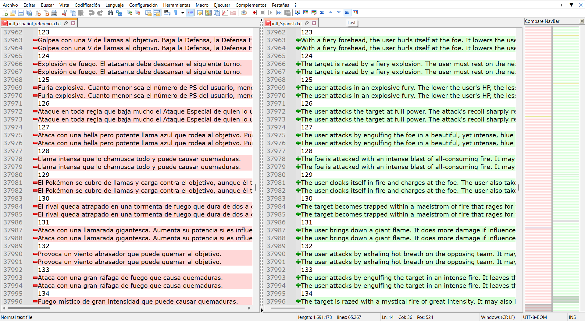

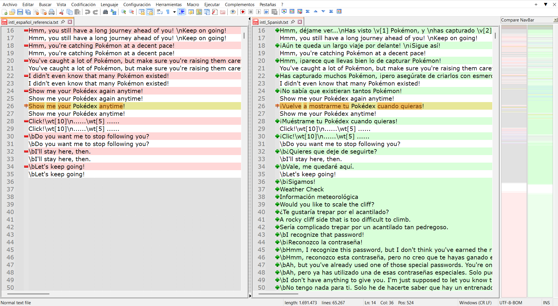

                    With that being said, I apologize again for not having explained myself as I should have.
                    Here are some more screenshots of the documents:
                    These are the first lines, which I have translated, as you can see. Those on the right that don’t have a pair on the left are new, because they weren’t in the “base game”, and were introduced in the game I’m translating. Those new lines, I’ll translate them myself, no copypaste.
                    Then, we have these kind of lines:
                    They DO HAVE a pair, but they don’t match, so I would have to translate them myself, too, ignoring the lines on the left (the “base game”).
                    There’s also lines such as these:
                    They have pairs, and I would have to double-click the ones on the left and replace ONLY the second lines on the right with the ones I copied from the left (because, when you’re translating a game made in RPG Maker, and you wish to add a translation, only the second lines after the original ones count for the translated version).
                    So, what I am looking for is some (quick) method to replace the lines with pairs (like the ones on the last screenshot).

                      If that’s not right, stop reading now: I’ve misunderstood what you are trying to do.
                      The first step in my suggestion is to copy just the sections you are trying to merge into two new files. That way you don’t have to worry about messing up anything else, and you can replace the section as a whole later.
                      To do that, use Ctrl+N (or File | New) twice, to make two new, empty tabs. In the Spanish file, highlight the part that has the numbers and paired lines (the third section you described). To do that, click on the line number to the left of the first line in that section. Scroll down using the mouse wheel or the scroll bar — not the keyboard — until you find the end of that section. Hold down the Shift key and click on the number to the left of the last line in that section. You’ll see that all the lines in the section are selected. Use Ctrl+C (or Edit | Copy) to copy that to the clipboard.
                      Now you can paste that into one of the empty tabs. (Click on the tab, then Ctrl+V or Edit | Paste.) Do the same thing for the English file and the other tab.
                      At this point, I suggest saving those tabs with new file names (Ctrl+S or File | Save: be sure to pick new names and save where you can remember where they are!). Saving work as you go along — so long as you don’t save into the original files — can help make sure you don’t have to start all over if something goes wrong. You can just open those files and resume from there.
                      OK, that’s the first step. If that makes sense to you, we can proceed. I’ll just explain below in a general sense what you would do next. I’m going to wait for you to get back to me before I go into more detail.
                      The next steps use regular expressions to perform a search and replace with patterns. Regular expressions are powerful, but somewhat challenging to understand at first. (You won’t need to understand how they work to do this part.) The object of these steps is to get the parts that go together (the number and the text) into a single line.
                      The reason for that is that in the next step, you’ll put the two files together and sort the lines. That puts the bits from the English file and the Spanish file that go together right next to each other. Notepad++ only has a way of sorting individual lines, not groups of lines; so that’s why you have to condense the number and text into a single line first.
                      Having done that, the last step uses regular expressions again, this time to find adjacent pairs of lines with the same number and put them into the original format (number, English and Spanish all on separate lines).
                      DrakyemD 1 Reply Last reply Reply Quote 2

                        BUT, I may have made a mistake by showing different examples with the same format, because the sections that I want to replace do not only come with numbers in it, and I’m going to show you right now:
                        It’s the exact same case, but without numbers. Also, some lines from the left side are not on the right side (see lines 55592 and 55593 on the left, for example).
                        In this case, lines 555596 and 55597 on the left side correspond to lines 55594 and 55595 on the right side.
                        Terry RT CoisesC 2 Replies Last reply Reply Quote 0

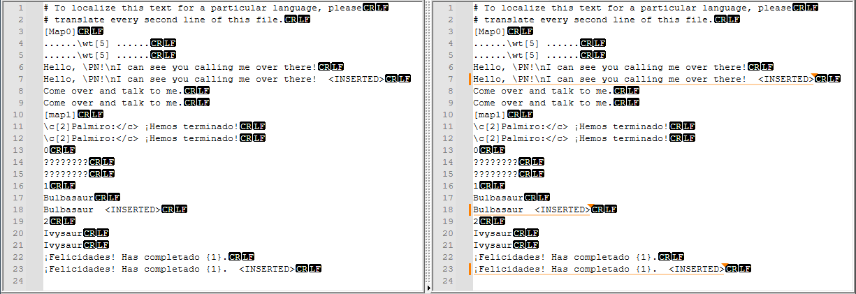

                                  Result after running the script:
                                  I enabled Change History to show in the lines and enabled End Of Lines to show to identify the affect of the modifications.
                                  If inspected as not OK then it can be undone with pressing Ctrl+Z on the right pane.
