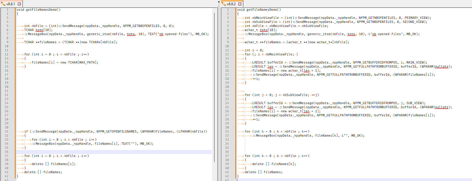

      Please note: per this commit, the
      NPPM_GETOPENFILENAMES, NPPM_GETOPENFILENAMESPRIMARY & NPPM_GETOPENFILENAMESSECOND messages are being deprecated. They will still be in the codebase for some versions, but will have _DEPRECATED at the end of the constant names in Notepad_plus_msgs.h – and they will be going away eventually.
      Don has updated the pluginDemo’s getFileNamesDemo() to show an alternate method to access the filenames that used to be obtained from NPPM_GETOPENFILENAMES, and I am placing those side-by-side here:
      Here is the version compatible with v8.8.2-and-forward, for easy copy/paste:
      void getFileNamesDemo()
      	int nbMainViewFile = (int)::SendMessage(nppData._nppHandle, NPPM_GETNBOPENFILES, 0, PRIMARY_VIEW);
      	int nbSubViewFile = (int)::SendMessage(nppData._nppHandle, NPPM_GETNBOPENFILES, 0, SECOND_VIEW);
      	int nbFile = nbMainViewFile + nbSubViewFile;
      	wchar_t toto[10];
      	::MessageBox(nppData._nppHandle, generic_itoa(nbFile, toto, 10), L"nb opened files", MB_OK);
      	wchar_t **fileNames = (wchar_t **)new wchar_t*[nbFile];
      	int i = 0;
      	for (; i < nbMainViewFile; )
      		LRESULT bufferId = ::SendMessage(nppData._nppHandle, NPPM_GETBUFFERIDFROMPOS, i, MAIN_VIEW);
      		LRESULT len = ::SendMessage(nppData._nppHandle, NPPM_GETFULLPATHFROMBUFFERID, bufferId, (WPARAM)nullptr);
      		fileNames[i] = new wchar_t[len + 1];
      		::SendMessage(nppData._nppHandle, NPPM_GETFULLPATHFROMBUFFERID, bufferId, (WPARAM)fileNames[i]);
      		++i;
      	for (int j = 0; j < nbSubViewFile; ++j)
      		LRESULT bufferId = ::SendMessage(nppData._nppHandle, NPPM_GETBUFFERIDFROMPOS, j, SUB_VIEW);
      		++i;
      	for (int k = 0 ; k < nbFile ; k++)
      		::MessageBox(nppData._nppHandle, fileNames[k], L"", MB_OK);
      		delete [] fileNames[k];
      	delete [] fileNames;
      It is recommended that you make analagous changes in any plugins that use one or more of those three messages as soon as possible.
