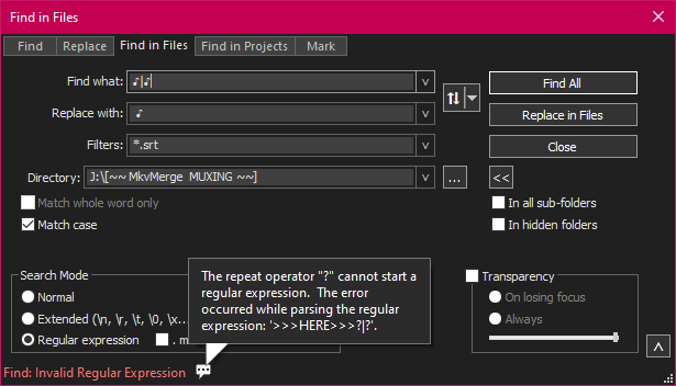

Sometimes I get the following error as well:
That really makes me think that Notepad++ thinks the file you are editing is ANSI, not UTF-8. Since the ANSI character set cannot represent the
♪character, then internal conversions use?instead – and so entering♪|♪in the search for an ANSI file becomes?|?when Notepad++ actually searches, which is invalid regular expression, because?is a modifier, not a literal. (I confirmed, if I create an ANSI file, whether or not it has that character, and try to do the search you showed, Notepad++ tells me that?|?is illegal, like your error message.)Make Notepad++ knows to read the file as UTF-8 using the Encoding menu I described in my first reply , because your subtitle files obvious are (based on the existence of the ♪ character in the file).

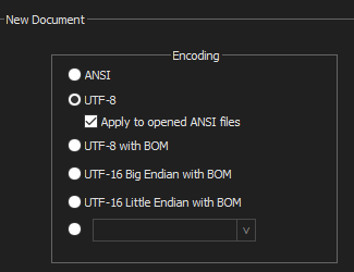

I pretty much use default setting, dark mode, added Proper Case to popup context and removed a few toolbar icons. I actually had to seach the to find the settings you mentioned. My auto-detect encoding checkbox was checked, I un-checked. As for “New Document” setting:
