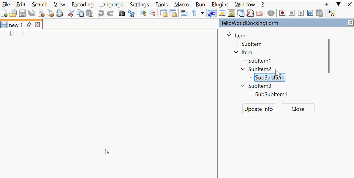

              First, I downloaded a current snapshot of the latest template sources from https://bitbucket.org/rdipardo/delphiplugintemplate/downloads
              • I changed the TreeView’s ReadOnly property to make it editable:
              --- a/Source/Forms/helloworlddockingforms.lfm
              +++ b/Source/Forms/helloworlddockingforms.lfm
                   Height = 146
                   Top = 8
                   Width = 238
              -    ReadOnly = True
              +    ReadOnly = False
                   ScrollBars = ssVertical
                   TabOrder = 2
                   Items.Data = {
              • I built the plugin and placed it in the load path of a compatible N++ version.
              • I clicked the toolbar button to show the docking form.
              • I double-clicked a list item and typed into it.
              • With focus still on the item, I moved the mouse pointer into the buffer window, then clicked.
              • Focus moved into the buffer window:
              I did however notice a different issue, namely, when editing a TreeView item while the form is “floating” (i.e., dragged into the buffer window area).
              In that scenario, the list item’s edit control cannot be unfocused at all; it hangs up the message loop until the “Not responding” system dialog appears and you request a hard shutdown.
              The solution probably involves some variation of Damjan Cvetko’s famous hack of toggling the WS_EX_CONTROLPARENT attribute flag in the form’s WM_NOTIFY procedure. It’s just a matter of finding out whether WS_EX_CONTROLPARENT needs to be set or cleared, and in response to which DMN_* message.

                      It’s a bit hard to identify in the gif screen cast when/where a click happens. So only for confirmation: (regarding a docking, not floating window here):
                      when you write/type into the npp editor buffer, the treeview’s node editor stays open, but when you click into it, it correctly closes?
                      The latter would tell me that i encountered a Lazarus flaw here, and i’d indeed need a LCL fix or such workaround as described.
