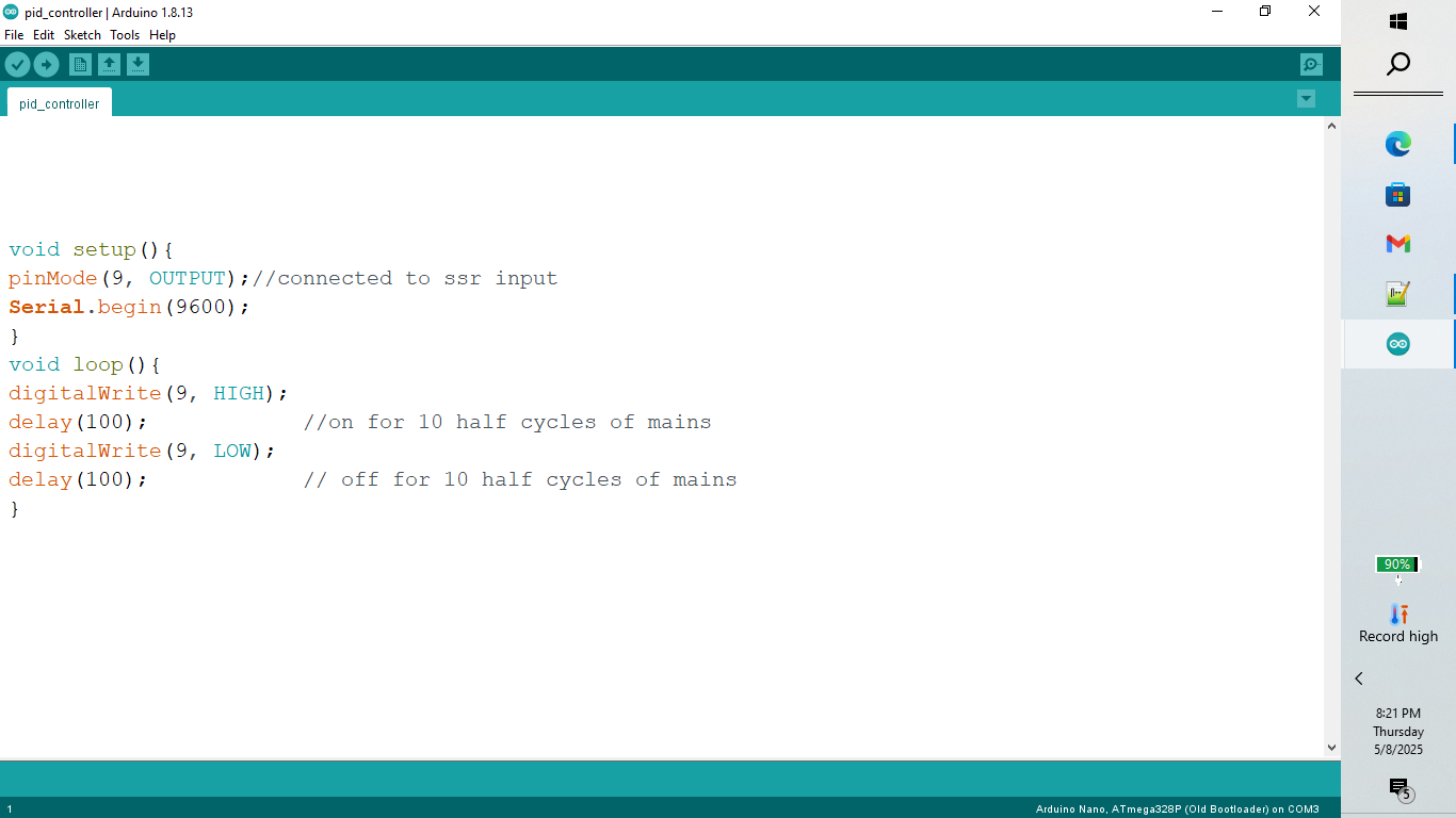

      Hi, I have a file in the app called pid controller. Some characters are in color. Can I get my printer Epson XP-2200 to print as shown in my document?
      I am attaching a copy of my file.

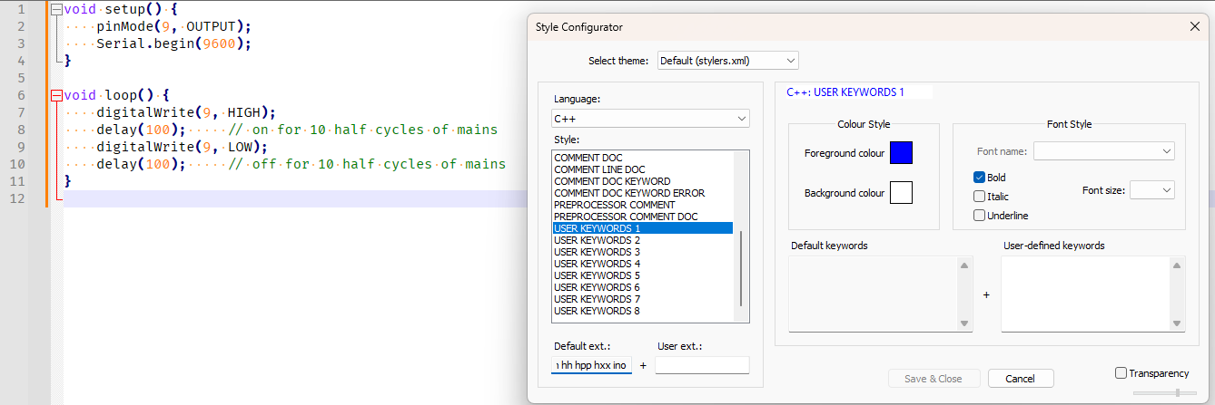

          Notepad++, by default, doesn’t know the Arduino-specific keywords/constants. But the Style Configurator has 8 “USER KEYWORDS #” styles for C++, and you can add your own keywords into User-defined keywords box for each, and define your own colors.

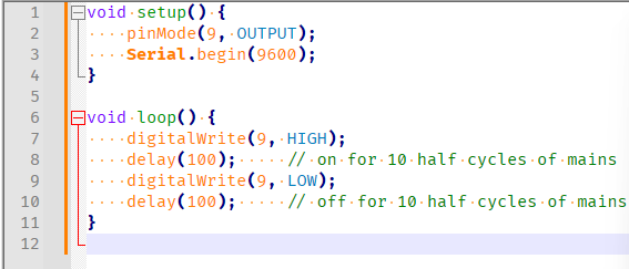

          Before:
          After:
          • Change USER KEYWORDS 1 to green, with setup loop
          • Change USER KEYWORDS 2 to orange, with pinMode digitalWrite delay begin
          • Change USER KEYWORDS 3 to bold+orange, with Serial
          • Change USER KEYWORDS 4 to aqua, with HIGH LOW OUTPUT
          You would have to go through and figure out any other keywords (I don’t currently have a list of arduino keywords, though you could probably search the forum for “Arduino” and maybe find something).
