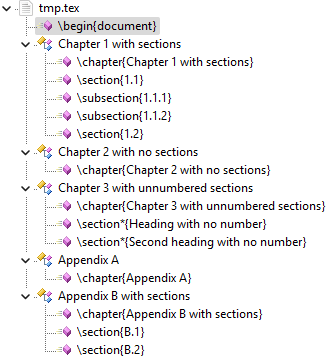

          Or, if you want to hide the \XYZ{...} wrappers around everything:
          |   link:    https://npp-user-manual.org/docs/function-list/
          <NotepadPlus>
          	<functionList>
          		<parser
          			displayName="LaTeX Syntax"
          			id         ="latex_class"
          			commentExpr="(?x)
          							(%.*?$)                                 # Comment
          			<function
          				mainExpr="(?x)                 # free-spacing (see `RegEx - Pattern Modifiers`)
          						  (?im-s)              # ignore case, ^ and $ match start/end of line, dot doesn't match newline
          						  \\(begin|
          						     part\*?|
          							 subsection\*?|
          							 subsubsection\*?|
          							 paragraph\*?|
          							 subparagraph\*?)
          					<functionName>
          						<nameExpr expr="(?xm-s)                                 # free-spacing (see `RegEx - Pattern Modifiers`)
          					</functionName>
          			</function>
          				<classRange
          					mainExpr    ="(?x)                                          # free-spacing (see `RegEx - Pattern Modifiers`)
          							(?m)                                                # ^ and $ match at line-breaks
          							(?'CLASS_START'
          								^                                               # NO leading white-space at start-of-line
          								\\(chapter\*?)
          							(?s:.*?)                                            # whatever,
          							(?=                                                 # ...up till
          								\s*                                             # ...optional leading white-space of
          									(?&amp;CLASS_START)                         # ...next header
          								|	\Z                                          # ...or end-of-text
          					<className>
          						<nameExpr expr="(?x)                                    # free-spacing (see `RegEx - Pattern Modifiers`)
          								(?<={)                                          # brace before name
          								.*?                                             # name
          								(?=})                                           # brace after name
          					</className>
          					<function
          						mainExpr="(?xm-s)                                         # free-spacing (see `RegEx - Pattern Modifiers`)
          									section\*?
          									|subsection\*?
          									|subsubsection\*?
          									|paragraph\*?
          									|subparagraph\*?
          						<functionName>
          							<funcNameExpr expr="(?xm-s)                           # free-spacing (see `RegEx - Pattern Modifiers`)
          						</functionName>
          					</function>
          				</classRange>
          		</parser>
          	</functionList>
          </NotepadPlus>
          which will yield:
          You can, of course, feel free to tweak it to match your desires.
          (Also, note that any class (ie, chapter) that doesn’t have a function (ie, section or similar) will not be listed in the FunctionList. That’s one of the quirks of the FunctionList.)

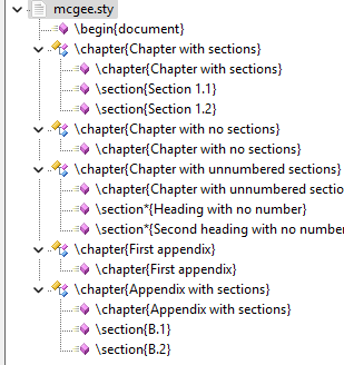

            As a workaround, could I have the <function mainExpr=x> just match the first thing in the chapter if it doesn’t find a \section in it? Meaning something like “IF \\section\*?{.*?} exists THEN match every instance of \\section\*?{.*?}, ELSE match the first instance of \S+.”
            Then there’d always be a “function” in every chapter and the “empty” ones would still show up.
            I don’t know how (or if its possible) to do that with regexes though.
              PeterJones @Jason McGee
              @Jason-McGee said in functionList for LaTeX: Trying to use classRange to have a hierarchical chapter > section document outline:
              With the way that the nesting works for FunctionLists (they don’t just do one regex; they do regex just on the results of previous regex, and it gets confusing), I am not certain how to accomplish that.
              I thought I could try to relax some of the rules, so that inside a \chapter, anything starting with \ would start a function (even the chapter!) – and because the chapter would match, then it would have contents. And that “worked” (as long as you don’t mind having each \chapter class repeated as a function in that class, too):
              But, unfortunately, as you can see, it doesn’t pick up the \appendix or the \include. If you needed it to, then this wouldn’t work for you. But if that’s an okay compromise, then here’s an XML

              • Jason McGeeJ
                Jason McGee @PeterJones
                Thanks @PeterJones, I really appreciate your time! I spent a chunk of time yesterday too trying to work out the regex if-then-else functionality before I gave up.
                I wouldn’t want to pick up everything that starts with \ because that will pull in a lot of commands that aren’t related to document structure (every command starts with \). For example, here’s my minimum working example with a numbered list in it, and that picks up the \begin{enumerate} and \items:

                … but picking up the \chapter{} as a function along with the \section{}s is a great workaround!
                Here’s what I have now:

                And the result on the sample file:
                I modified the classRange mainExpr because I wanted to also match indented \chapter{}s (like I have for the appendices in the new sample file). After that change I found that the last \chapter{} wasn’t being matched with \Z so I changed the alternate search to look for \end{document} instead (which will always appear) and that worked.
                Thanks for your help!
