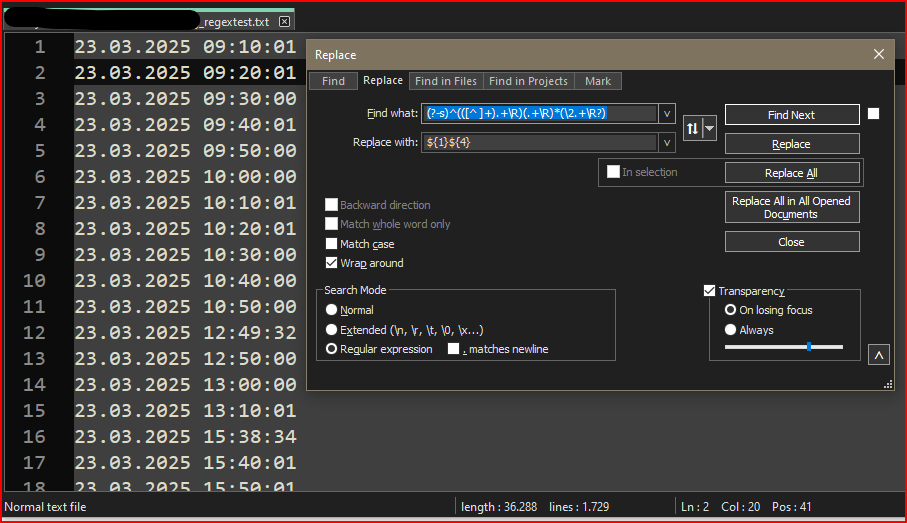

        Find What:(?-s)^(([^ ]+).+\R)(.+\R)*(\2.+\R?)
        Replace With:${1}${4}
        As this is a regular expression your search mode needs to be set to “regular expression”. Make sure the cursor is at the start of the first line as it needs to work with the first of these sorts of lines to correctly identify the “matching” pairs of dates. It will also work if there are only 2 lines with the same date, it returns the 2 lines in this instance.

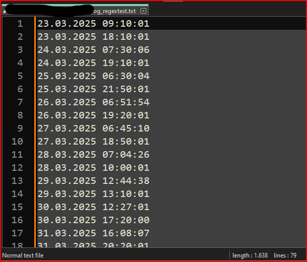

          @Terry-R said in Remove "duplicate" lines based on only a specific part of the line:
          @Terry-R
          This is REALLY GREAT!
          Before:
          After:
          How can you do something like that?
          Really amazing, many, many thank you!
