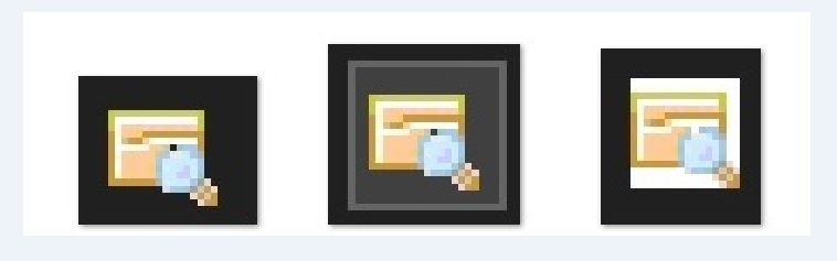

                  In fact it is so that now, where i repeated the steps for to make an illustrative image, i have to notice that i was pretty sure to have (following the windows docs) tried
                  LoadImage(… , LR_LOADMAP3DCOLORS) as well as LoadImage(… , LR_LOADTRANSPARENT) as well as LoadImage(… , LR_LOADMAP3DCOLORS or LR_LOADTRANSPARENT),
                  but something must have been wrong here, because indeed the latter version does remove this ‘glow’ also.
                  HTbBmp := LoadImage(Hinstance, 'TB_BMP', IMAGE_BITMAP, bmpX, bmpY, LR_LOADMAP3DCOLORS or LR_LOADTRANSPARENT);
                  The illustration:
                  • the left image shows the example bitmap from the reference plugin, without regard if the plugin is loaded/active or not
                  • the correction using LR_LOADMAP3DCOLORS looks fully identical. But only if my plugin is not loaded. If loaded,
                    it looks somehow like ‘focused’ (but not exactly the same) -> image in the middle.
                  • the right image shows how it would look only using LR_LOADTRANSPARENT.
                    With ‘LR_LOADMAP3DCOLORS or LR_LOADTRANSPARENT’ it looks again exactly like in the left image, without regard if the plugin is loaded or not; it’s all ok.
                    Please note, the reference plugin does use this combination only for the ICOs … Not for the BMPs.
                  To my interpretaton the ‘fluent’ images are an independent story, but i may be wrong here.
                  What i see is that for the plugin’s toolbar image the BMP is used, without regard of light or dark.
                  When being within Settings > preferences > general > standard icons: small.
                  The ‘fluent’ images (based on each an ICO for dark and light) come into play (imo) only when chosing the fluent UI items within this preferences, if i see right.
                  Edit: i missed to add an image for the original rendering, which had motivated this thread:
