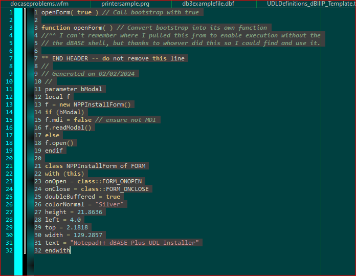

      gooly @gooly
      @goolyThank you, but this does not work with copy (Ctrl+C) & paste (Ctrl+V) :(
      Any solution for this?

        @gooly said in posting code (by copy & paste) with line numbers:
        The line numbers aren’t part of the text, so Notepad++ doesn’t have them available for copy/paste with the text normally.
        In theory, one could ask for that as a feature (but I doubt it’s likely to be implemented); as a second alternative, one could write a script in a scripting plugin (like PythonScript), which would do the copy then insert the line numbers, or someone in theory could write a full plugin to accomplish this (maybe some other plugin already has copy-with-line-number, but I don’t know of it); but if you are willing to do a multi-step process, it can be done in native Notepad++:
        1. One Time Setup: for a normal installation of Notepad++,
          1. File > Exit all copies of Notepad++, then run one copy of Notepad++.
          2. File > Open: %AppData%\Notepad++\shortcuts.xml
          3. Just before </Macros>, add:
            <Macro name="NumberLines" Ctrl="no" Alt="no" Shift="no" Key="0">
                <Action type="3" message="1601" wParam="0" lParam="0" sParam="^" />
                <Action type="3" message="1602" wParam="0" lParam="0" sParam=" | " />
                <Action type="3" message="1702" wParam="0" lParam="768" sParam="" />
                <Action type="0" message="2316" wParam="0" lParam="0" sParam="" />
                <Action type="2" message="0" wParam="42089" lParam="0" sParam="" />
                <Action type="0" message="2318" wParam="0" lParam="0" sParam="" />
                <Action type="0" message="2312" wParam="0" lParam="0" sParam="" />
                <Action type="2" message="0" wParam="42034" lParam="0" sParam="" />
            </Macro>
            <Macro name="UnNumber Lines" Ctrl="no" Alt="no" Shift="no" Key="0">
                <Action type="3" message="1601" wParam="0" lParam="0" sParam="^\h*\d+ \| " />
                <Action type="3" message="1602" wParam="0" lParam="0" sParam="" />
            </Macro>
            and save
          4. File > Exit, then run one copy of Notepad++.
        From now on, you have two new macros in the Macro menu: Number Lines and UnNumber Lines (and, if you want, you can use Macro > Modify Shortcut/Delete Macro to launch the Shortcut Mapper to add a keyboard shortcut for running these macros)
        Every time you want to copy some or all of your code with the line number:
        1. Run Macro > Number Lines, which will add a | at the beginning of every line, then launch the Column Editor
        2. Fill out the Column Editor as follows:
          • ⦿ Number to Insert,
          • Initial Number: 1
          • Increase by: 1
          • **Repeat: ** (leave blank)
          • Leaing: Spaces
          • Format = ⦿ Dec
          • Click OK
            (it will remember these values for next time)
        3. Do your copy of the code (some or all lines, as you desire)
        4. When done copying code-with-line-numbers, run Macro > UnNumber Lines to remove the line prefixes
