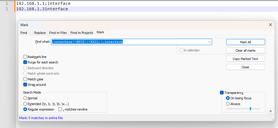

                  @Alan-Kilborn Sorry, that should be ;interface(*SKIP)(*FAIL)|interface on Notepad++. I thought I had deleted the last ; (semi-colon) but while pasting it above, I pasted it with it

                    @dr-ramaanand said in need help to look for a word:
                    @Alan-Kilborn Yes, please check it out on Notepad++
                    It didn’t work. It found 0 matches, when it should have found one. Please be careful when giving advice, that it at least does what you claim it does.
                    This is not a situation where you need the complications of skip/fail. As @Alan-Kilborn showed, it can be done with a simple non-regex search; if it can be done simply, trying to apply the complicated formula is the wrong thing to do. Even with regex, it would be easier in this case to use a fixed positive negative lookbehind (since the semicolon is always one character, you don’t need to worry about variable size, so the Boost regex engine can handle th lookbehind just fine), rather than trying to apply the advanced skip/fail.
                    To future readers: the post I quoted got changed while I was replying to it. Sorry that it makes it look like I was making up quotes. Even after @dr-ramaanand’s change to his post, my claim that this is not a situation where skip/fail is needed still stands.
                    dr ramaanandD 1 Reply Last reply Reply Quote 2
