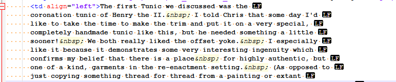

      Fellow Notepad++ Users,
      Could you please help me understand LF and <br>?
      I have removed any CR and <br>tags in my HTML (this is in a table form)
      When I copy my edited text into my (WordPress) page, save and review the draft there are still line breaks after each line:
      Example: (What it looks like in Notepad ++

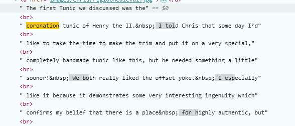

      When I inspect it, a <br> has been inserted at the end of each line.
      I thought perhaps the LF is a <br>, but if I remove them all then the editor looses all the line numbering (and I have not found any other way to to wordwrap the text)
