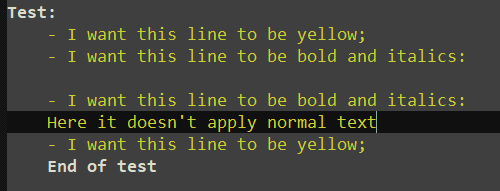

      I want to style the lines that begin with “-” and end with “;” as yellow, and the lines that begin with “-” but end with “:” as bold and italics.
      Somehow that doesn’t seem to work, not even tinkering with the nesting option for both styles:

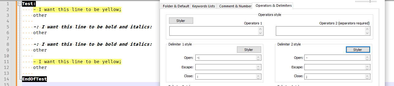

        I believe the underlying logic in the UDL parser for Delimiters goes through the OPEN for each DELIMITER# until it finds a matching one, at which point it switches to that style, whether or not it finds the matching CLOSE (because EndOfFile is always a valid CLOSE for delimiters, in the UDL logic) – it’s not looking for the OPEN/CLOSE pair, but just for the OPEN.
        Thus, if Delimiter1 and Delimiter2 both use the same OPEN, it will always choose Delimiter1.
        If you could use something like -; as your opening for the yellow, and -: as your opening for bold+italics, or -: for bold+italics and plain - for yellow, then it would be workable (as long as the longer -: was in the lower Delimiter# if you choose the latter pair)…
        Here’s an example with Delimiter1 = -: to : , with Bold+Italic, and Delimiter2 = - to ; with Yellow background (which in my light-mode is more visible; you can of course set colors as you want)

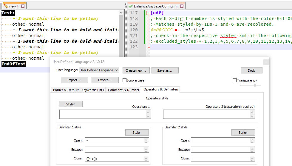

        It still won’t be exactly what you claimed, but if you’re willing to have yellow+bold+italic instead of just yellow, then I would suggest Delimiter1 = - to ((EOL)) with bold+italics, and then use EnhanceAnyLexer to add the definition 0x00CCCC = -.*?;\h*$ , which will end up looking like:
        … which might be close enough for your needs.
        If your UDL is called FrancescoUdl, then the header that EnhanceAnyLexer will create in EnhanceAnyLexerConfig.ini will be [FrancescoUdl] instead of [udf] in my example – doing Plugin > EnhanceAnyLexer > Enhance current language will always create or jump to the appropriate [languageHeader] section in the config file; mine was called [udf] because that’s the underlying name if you choose Language == User-Defined at the end of the Language Menu
        And until you are trying to add extra logic about where EnhanceAnyLexer will or will not apply a given color=regex definition, I recommend always commenting out the excluded_styles row using the ; prefix, as shown (it defaults to excluding most styles, which is may be confusing to a new user)
