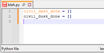

      I have been using Notepad++ since the days of Python 2. I have always found the colouring applied to Python code sensible and intuitive … until recently. For example, why is the variable within “civil_dawn_done = []” coloured orange and in italics, whereas within “civil_dusk_done = []” plain black (which I assume is correct)?

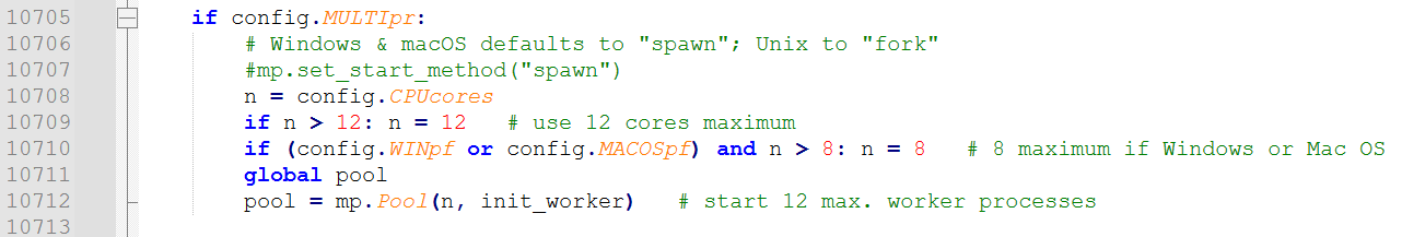

      I fully approve when text (raw or not) within triple apostrophes is highlighted orange. That’s very useful. But again - one of my config variables (PV_nsa within “config.PV_nsa”) is highlighted orange italics. Why?

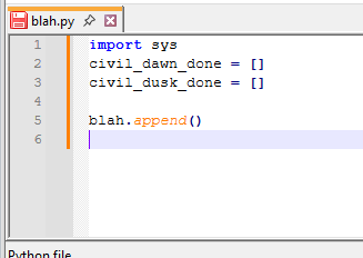

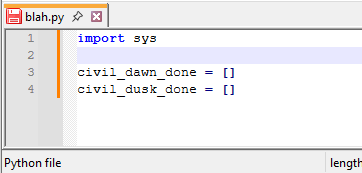

        It’s not specifically the variable names you showed, because they work right for me here:

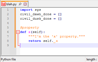

        It’s actually in how you are starting the file, as in my example here:
        There is a known bug in the “Lexilla” library that Notepad++ uses for syntax highlighting, where if the first line of a python file starts with an identifier, it will mis-categorize the identifier as a decorator (which is supposed to be for things like the @property decorator):
        Until the Lexilla library is fixed, Notepad++ cannot fix the problem. But in general, Python code usually starts with a #!shebang or # other comment or at least an import statement like I showed in my first example, so putting a shebang/comment/import before your first identifier should fix the civil_dawn_done problem.
        A bit further “.append” is highlighted with orange italics.
        I assume you mean like:
        That’s the ATTRIBUTE styling, which is applied to attributes and methods. If you don’t like that color, you can change Settings > Style Configurator > Language: Python > Style: ATTRIBUTE to set whatever color/bold/italic/underline you want for method calls and attributes.

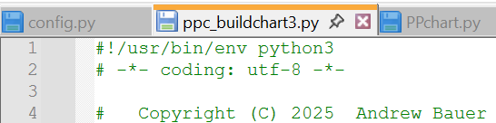

          @PeterJones Many thanks for your prompt reply. I didn’t include any screenshots, however my code begins with the expected #!shebang…

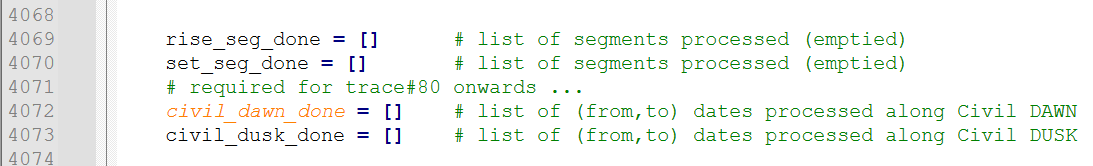

          Currently this Python module has 10,792 lines of code, and on line 4072 I saw the unexpected orange italic highlighting, which made no sense to me.
          All variables within the external ‘config.py’ module are highlighted, so this appears normal expected behaviour however it is called, e.g.:

            PeterJones @Andrew Bauer
            As part of the same bug report, it was mentioned in one of the replies on the issue, that ending a Python comment with a . triggers the attribute formatting on the next line.
            This is because it’s looking for . followed by 0-or-more-whitespace (which includes newline) followed by what would otherwise be an identifier, and if it finds that, then instead of identifier, it treats the word as an attribute/method instead. So, to get around that bug, either remove the ... at the end of your comment, or put some other (non-whitespace) character after the ... - maybe use : instead of ...
