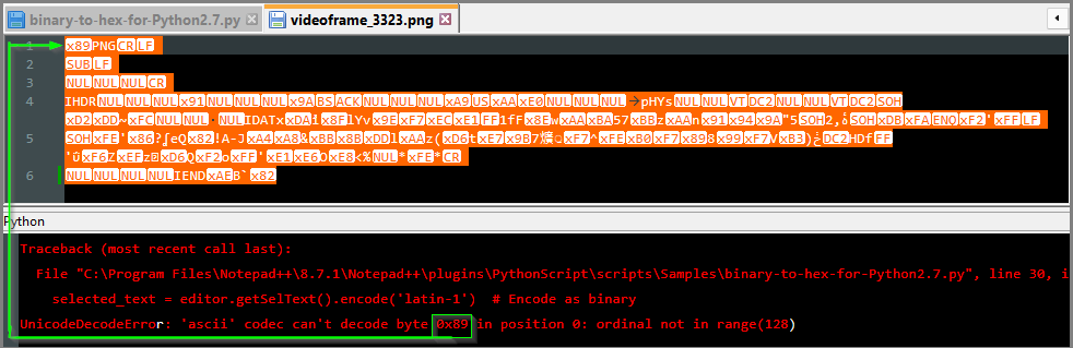

      Hey Guys…need some help again with binary to Hex It seems I’m back to square one when trying to create a working python script that translates the Unicode to binary before converting to Hex. Error reads: UnicodeDecodeError: ‘ascii’ codec can’t decode byte 0x89 in position 0: ordinal not in range(128)
      import re
      # Use a very large number of chars per line to keep it on one line.
      CHAR_PER_LINE = 1 << 63
      def convert_to_hex_lines(binary_data):
          # Convert binary data to hex representation
          raw_hex = ''.join('%02X' % ord(byte) for byte in binary_data)
          if CHAR_PER_LINE >= len(raw_hex):
              return raw_hex
          return '\r\n'.join(re.findall('.{1,%s}' % CHAR_PER_LINE, raw_hex))
      # Read the binary data from the selected text in Notepad++
      selstart = editor.getSelectionStart()
      selend = editor.getSelectionEnd()
      if selstart == selend:
          # If no selection, read the entire document as binary
          editor.beginUndoAction()
          editor.setReadOnly(False)
          editor.selectAll()  # Select all text
          binary_data = editor.getText().encode('latin-1')  # Encode as binary
          hex_output = convert_to_hex_lines(binary_data)
          editor.setText(hex_output)
          editor.endUndoAction()
      else:
          # If there is a selection, convert only the selected text
          selected_text = editor.getSelText().encode('latin-1')  # Encode as binary
          hex_output = convert_to_hex_lines(selected_text)
          editor.replaceSel(hex_output)
      Any help would be appreciated
      • CoisesC
        Coises
        I don’t know Python, so I could be mistaken, but I think your approach cannot work reliably. I believe editor.getText() and editor.getSelText() return Python strings, which are always utf-8. Immediately there will be a problem: 0x89 is not a valid start for a utf-8 character, so if the document coding is set to utf-8, the result will be invalid; if it’s something else, the transformation might not be what you expect. I suspect what is happening here is that your document encoding is set to utf-8, and Python is balking when the code behind editor.getSelText() tries to put that in a Python string.
        You might have better luck with editor.getCharAt(), which, according to documentation returns an integer rather than a string. Loop through the selection one byte at a time and convert each byte to hex.

            Don’t use editor.getText with binary files. Notepad++ treats the file’s text as a NUL-terminated string for the purposes of that command, and most other text-retrieving commands. Apparently there are some ways for a plugin to get around this, but they are undoubtedly much more arcane.
