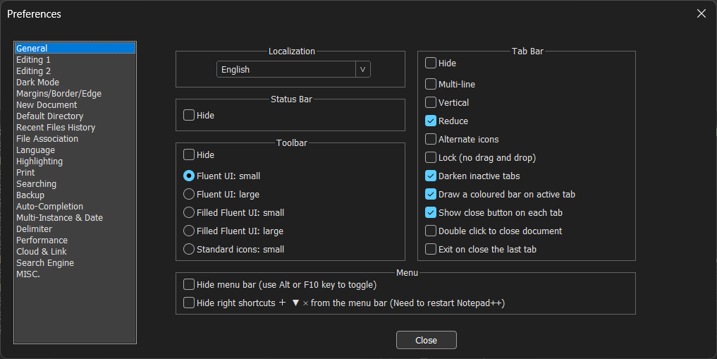

            @PeterJones Is there a way to select multiple lines and do an action? Is that not the case? Am I just not explaining it clearly? I have seen people do that before when sharing code in presentations. I have seen people add // and , in front of various code.
            Where is this hiding? Not seeing it. Have the settings been moved around?

                PeterJones @Bob Smith
                @Bob-Smith ,
                Sorry, you didn’t say which version you were on, so I assumed a recent version, like v8.7.1 (which was the most recent version to trigger auto-update) – specifically, the option was moved in v8.7 in September of this year, as mentioned in the User Manual. In your older N++ copy, it’s still in the old Settings > Preferences > Language page, instead.

                  Terry R @Bob Smith
                  @Bob-Smith said in notepad ++ adjust indentation:
                  Which version of Notepad++ are you running. The preference option is certainly there in the recent versions. You might need to show us your debug info. From the ? menu, select debug info, copy and paste that info here.
