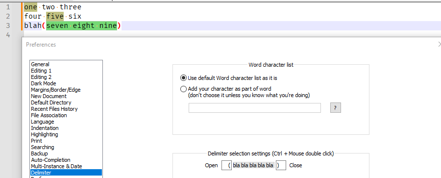

        So with the example text
        one two three
        four five six
        blah(seven eight nine)
        if I Ctrl+DoubleClick on one then five then eight, I get one and five and seven eight nine selected. Based on being reminded of the existing of the special meaning for inside-delimiter Ctrl+DoubleClick, that is now my expectation. But I’m wondering if you were hoping for just one and five and eight in that situation. If so, you would have to “defeat” the Delimiter selection settings, by changing the open and close delimiters to something else (or to nothing).
        Examples:

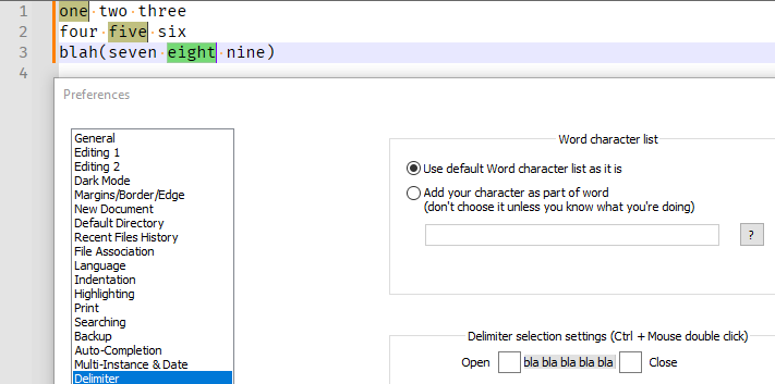

        Default:
        With no selection-delimiters:
