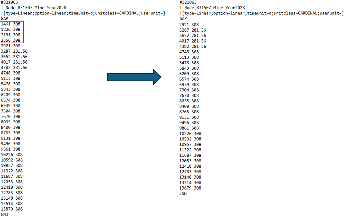

      Hello,

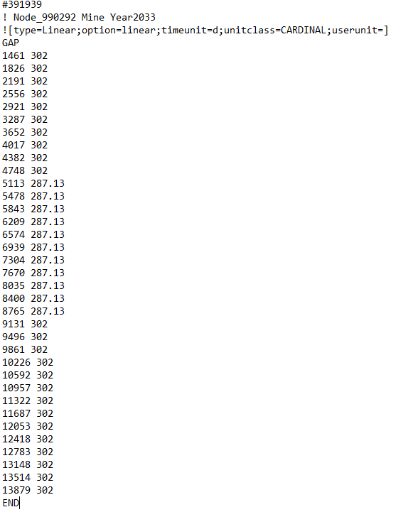

      I have a very large dataset with over 10 million lines of data.
      The data format is shown in screenshot below
      I have more than 400,000 set of these data line by line in this text dataset file. The first 4 lines in the example are like headers and the data I want to clean up starts with 1461 302; 1826 302, etc. In the second column, values start with 302, then change to 287.13, then return back to 302. Different small dataset have different values. But the pattern is the same.
      I want to remove the lines where the second column value are the same before it changes to a different value. And I want to keep the last row of data before second column value changes.
      So my desired data format will be as below:
      I successfully did this operation last year using Notepad++ but forgot how I did it. What I remember was I used the Search/Replace function and Line Operation and Bookmark function to first select all the rows I want to delete, then delete them.
      Please help me with this issue. Very much appreciated!

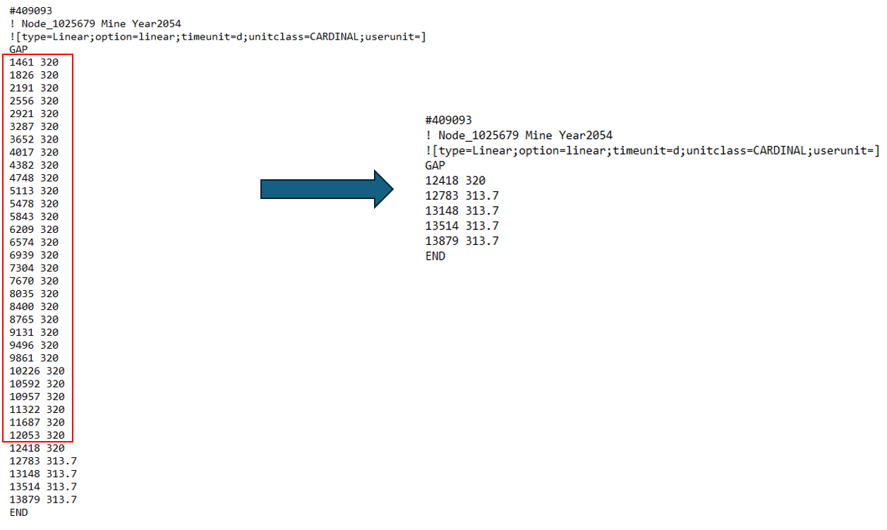

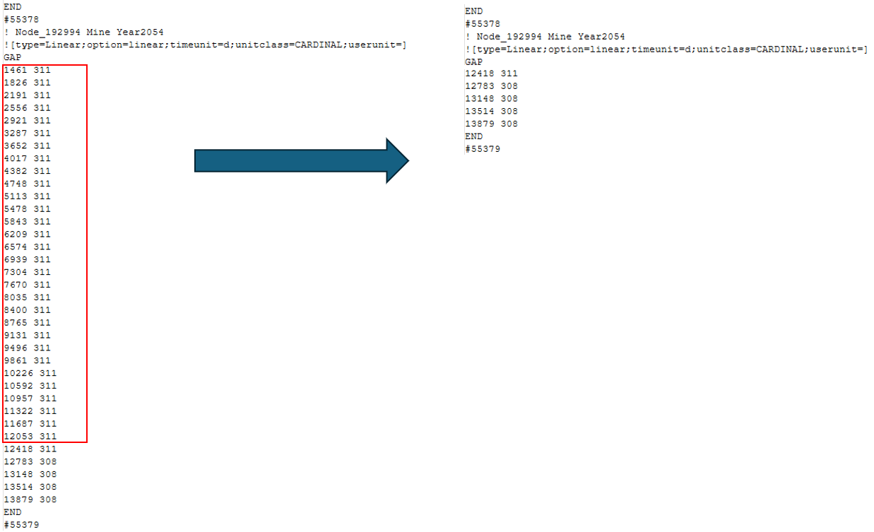

        • Jizhao LiJ
          Jizhao Li @Coises
          @Coises
          Hi, thank you so much for your quick reply.
          Sorry my description is off and hard to understand. But the desired data format in the second screenshot is correct.
          Hopefully picture below can clarify my question better:
          I want to delete the rows circled in red and keep the rest.
          Thank you!!!

            I feel like I might still be missing something.
            Are you saying that you only want to delete the lines with duplicate second values in the first group that follows a line with only the letters GAP in it?
            If that’s the case, then try changing my suggestion to:
            Find what: ^GAP\R\d+ ([\d.]+)\R(?:\d+ \1\R)*(\d+) \1$
            Replace with: GAP\r\n\2 \1
            I’m assuming you want to replace this more than once (or you’d just do it by hand) — either it occurs multiple times in one file, or one time in multiple files, or multiple times in multiple files — but I’m having trouble grasping what differentiates the specific group of lines you want to remove from the other groups of lines that follow the same pattern.
            Jizhao LiJ 1 Reply Last reply Reply Quote 1

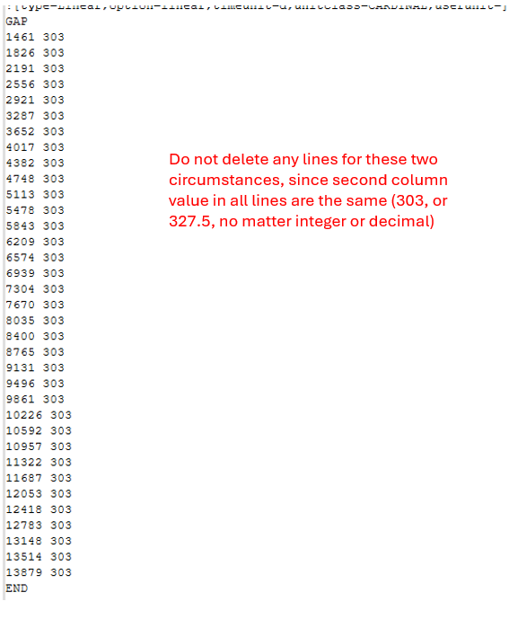

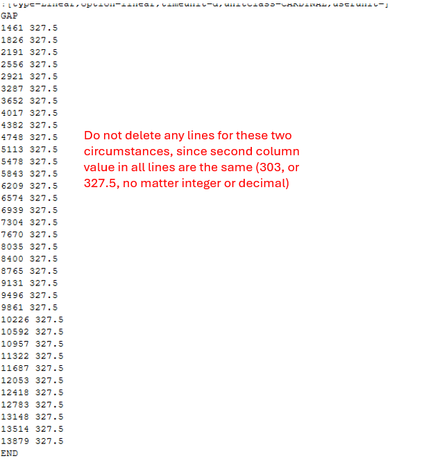

                    Your understanding is mostly correct, but there are two circumstances I missed clarifying:
                    1. About the line with decimal number. The line beforewhich I want to replace all lines of text, doesn’t need to have a decimal number in the second column, but a different value than what the earlier lines (lines I want to remove) have. See examples below:
                    2. There are some circumstances where the second column values are the same for all rows between a GAP and a END. In these cases, do not delete any lines, keep them all. See example below:
                    Thank you so much for your help. Your regex definitely helps. If you could slightly adjust it to account for the two circumstances I mentioned above that would be great and much appreciated!

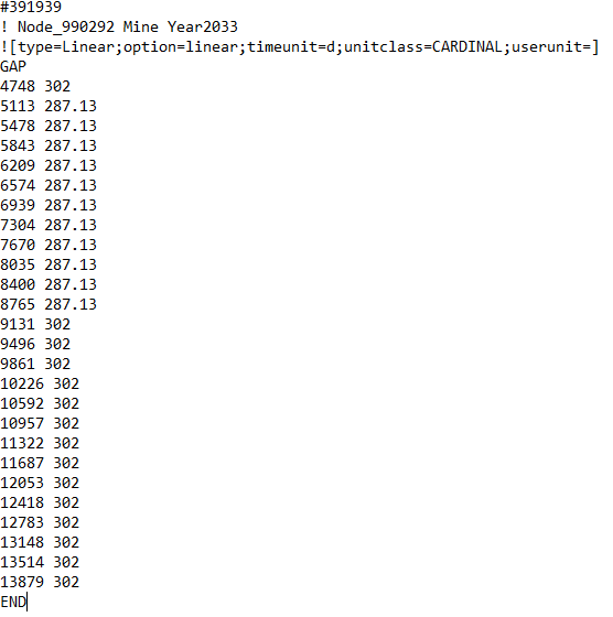

                    • Jizhao LiJ
                      Jizhao Li @Coises
                      Hi @Coises,

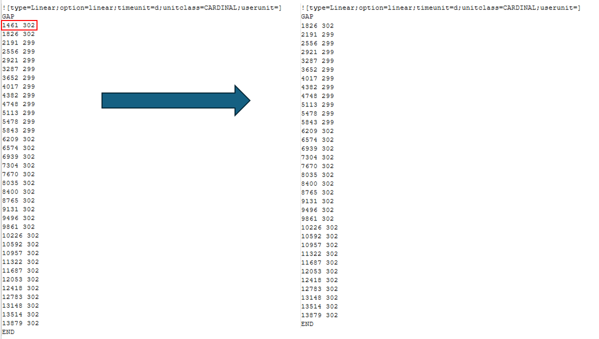

                      Thank you so much for your help. I just tried your regex codes and it worked almost 100% for my problem.
                      There is one circumstance where it didn’t give me the format I wanted, which is shown in the screenshot below:
                      In this case there is no duplicate second values in this group of data and I actually want to keep all the rows as they are and don’t delete any rows. But using your regex code all the rows except for the last row were deleted.
                      Basically your code works perfectly when there IS a duplicate values in the second column. But when there is NO duplicate values in the second column, I want to keep the original data as they are.
                      I hope this doesn’t add more confusion. Could you please adjust the code and send it to me? Thank you so much!
                      • CoisesC
                        Coises @Jizhao Li
                        @Jizhao-Li said in Remove data lines with same value in certain column:
                        I think I understand. You want to delete all but the last line from the first set of lines with the same second number that follows “GAP,” but only if there is at least one additional set of lines following.
                        Try changing the find expression to:
                        ^GAP\R\d+ ([\d.]+)\R(?:\d+ \1\R)*(\d+) \1(?=\R\d+ \d+$)(?!\R\d+ \1$)
                        That’s the same test, except it checks to see that it is followed by a line that has two numbers, but not a line with has two numbers with the same second number.

                          The following regex S/R should do the work nicely :
                          SEARCH (?-is)^(GAP\R)(\d+ (\d+(?:\.\d+)?)\R)+?(?=\d+ (?!\3$))
                          REPLACE \1\2

                          4382 123.012           GAP
                          4748 123.012           5478 123.012
                          5113 123.012           5843 456.789
                          5478 123.012           6209 456.789
                          5843 456.789     =>    6574 456.789
                          6209 456.789           6939 456.789
                          6574 456.789           7304 456.789
                          6939 456.789           END
                          7304 456.789
                          END
                          GAP
                          4017 123               GAP
                          4382 123               4748 123
                          4748 123               5113 456
                          5113 456               5478 456
                          5478 456               5843 456
                          5843 456         =>    6209 456
                          6209 456               6574 123
                          6574 123               6939 123
                          6939 123               7304 123
                          7304 123               END
                          END
                          GAP
                          4017 123.012           GAP
                          4382 123.012           4748 123.012
                          4748 123.012           5113 456.789
                          5113 456.789           5478 456.789
                          5478 456.789           5843 456.789
                          5843 456.789     =>    6209 456.789
                          6209 456.789           6574 123.012
                          6574 123.012           6939 123.012
                          6939 123.012           7304 123.012
                          7304 123.012           END
                          END
