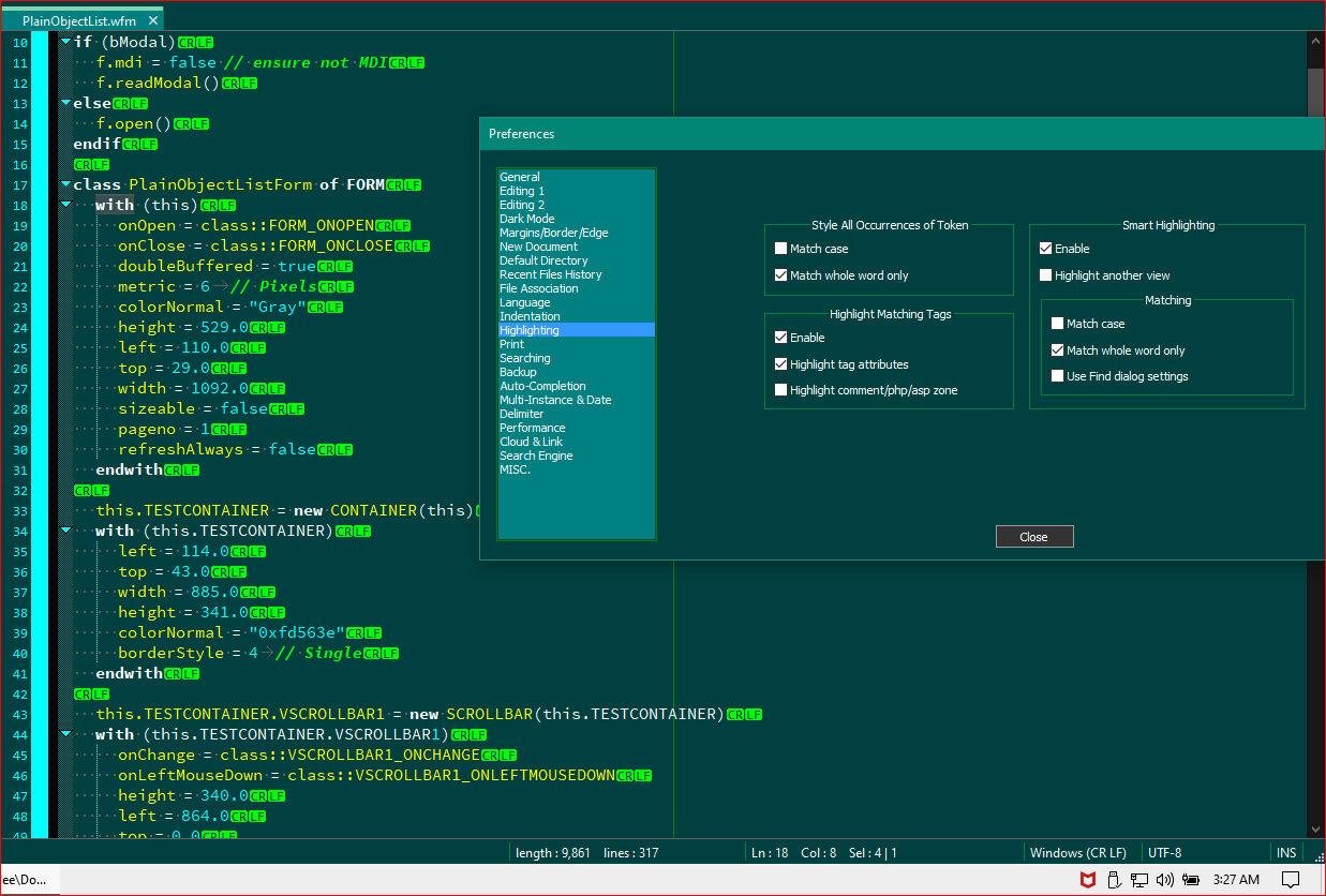

      I did search the forum and the web in general but I was not able to find a solution to my issue. I did try a couple things listed in other posts.
      I have used Notepad ++ for over 10 years and up until the last update I have had no issues.
      As of 8.7.1 My smart highlighting is not working.
      I checked Preferences > Highlighting - Highlight matching Tags and Smart Highlighting are enabled. I have disabled and re-enabled. I have changed multiple options in the Highlighting settings.
      Style Tokens do highlight the multiple instances of tags or words.
      I have uninstalled and reinstalled. When I uninstalled I removed all directories related to NPP (Install Folder and %APPDATA%\Roaming)
      I have changed from 32 bit to 64 bit. I originally stayed with 32 bit due to plug-in compatibility.

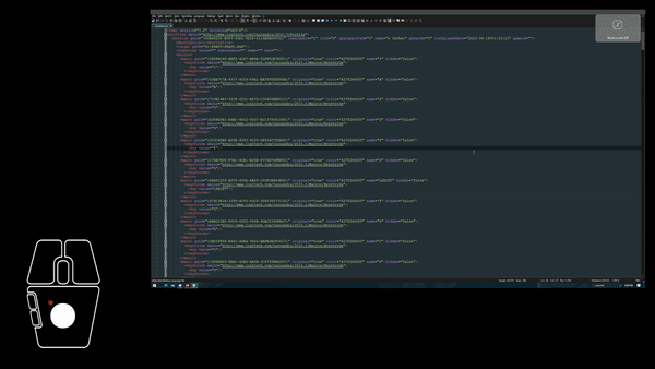

      Video with input overlay so you can see mouse clicks and double clicks. Grey bar across the top to hide personal information.
      https://drive.google.com/file/d/10avx-310JZet_L58weFm79Havt-hEsfE/view?usp=drivesdk
      same video different host
      https://youtu.be/FNJShIZfL_Y

      • Lycan ThropeL
        Lycan Thrope @Michael Belew
        @Michael-Belew ,
        Best you post the picture or video here, as I don’t follow links posted by most people, and certainly not first posters. I don’t suspect many of us do as that invites bad actors to compromise our systems.
        If it can’t pass the forums checks, it won’t make it to be viewed here meaning I don’t want to follow it either.

          You can also use a URL checker to check the safety of a link. Google has its own version of a URL checker called Google Transparency Report. To check the safety of a link, all you have to do is safely copy the link and paste it into Google’s URL checker. To safely copy a link, right-click and choose “copy link” from the options that appear. When copying the link, be careful to not click on it accidentally.
          Second the forum has no obvious way to post a video, only images. I provided 2 links to the same video, both Google owned sources, to try and make people more comfortable.
          I have converted the video to make it an animated GIF, but all of the converters online limit this length of video to 8 fps, which may make it difficult to see double clicks and other fidelity.

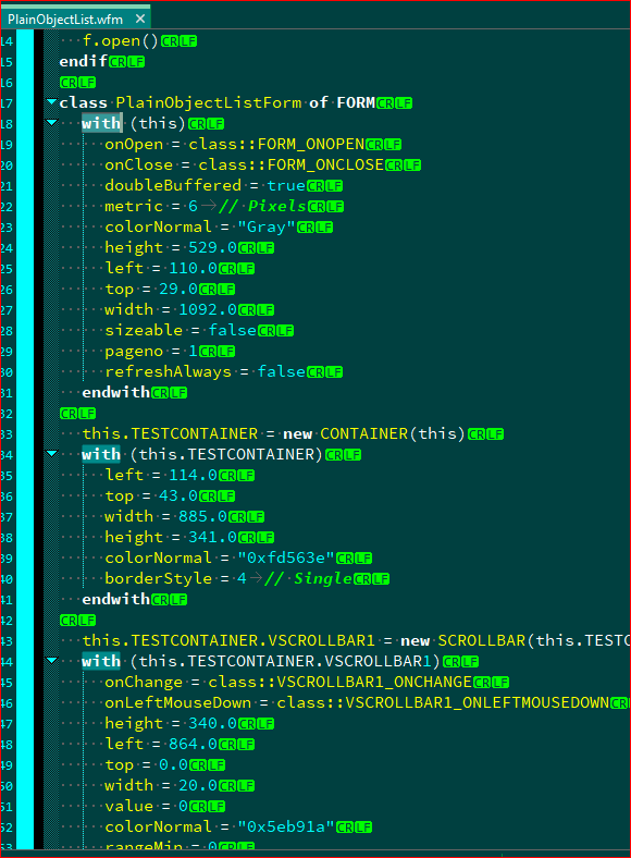

                Below is the screenshot and enough code to try for comparison.
                Here is a screenshot of the word (that you helped me with for the UDL) with selected along with the Highlighting preferences section showing. Only the one selected is highlighted, notice the ones underneath are not.
                Code:

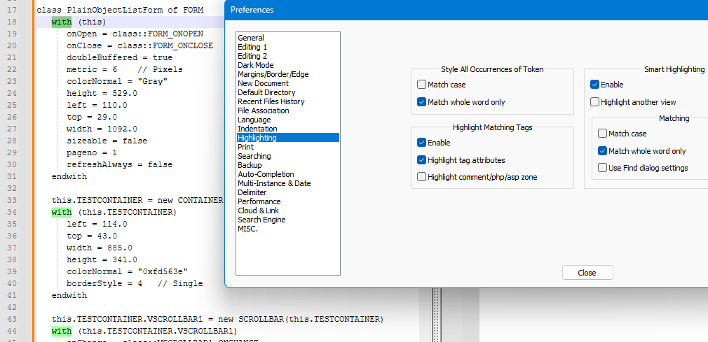

                    Alan Kilborn @Lycan Thrope
                    @Lycan-Thrope
                    I don’t have any problem (using 8.7.1) with Smart Highlighting and your example:
                    MarkusBodenseeM 1 Reply Last reply Reply Quote 0
                    • MarkusBodenseeM
                      MarkusBodensee @Alan Kilborn
                      @Alan-Kilborn said in Smart Highlight not working:
                      Same for me, works as expected. Maybe a problem in relation with the UDL or a plugin?

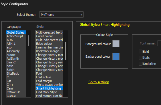

                        Ekopalypse @Lycan Thrope
                        @Michael-Belew
                        perhaps your theme has set the background color of the smart highlighting to match the default background color?
                        Lycan ThropeL Michael BelewM 2 Replies Last reply Reply Quote 3

                          @Ekopalypse ,
                          Bingo, we have a winner. I have no idea why that color was selected as the same background, or…it was by default and then when I changed my background color to what it is now, the conflict occurred. I never noticed it, but I’ve changed it to a cyan, and it does show up now.
                          Thanks for that catch.
                          Thanks to all for their suggestions, and maybe the OP can now check his settings to solve his problem.
                          OP, might have the same problem. If you notice, the first with has different coloring than the others, I suspect the result of the current selection color choice being melded with the SmartHighlighting background color.

                            @Ekopalypse I know this is very old post, I have just lived with it till now. I started to try and find the answer again and found my own old post. You are correct the background for the Global Style Smart Highlighting was set to the default background. This fixed my issue.
