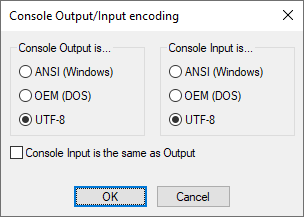

      PeterJones @CyReX1986
      @Kay-Haldor-Øvredal-Gjuvsland ,
      Another option is to set that Console Output… dialog to UTF-8 for both input and output,
      … and to use python3’s -X utf8 command-line argument.
      By adding a \u236a-encoded smiley, you can see better that without that -X, python is applying heuristics to determine what encoding to use when printing; and the NppExec environment is capturing the STDOUT/STDERR from anything executed in its Console, so the heuristics don’t necessarily come to the right conclusion.
      Here are some screenshots in OEM/OEM, ANSI/ANSI, and UTF8/UTF8:
      python -c "print('æøå')"
      python -c "print('æøå\u263a')"
      python -X utf8 -c "print('æøå\u263a')"
      The error message for the python -c "print('æøå\u263a')" shows that Python3 is trying to use the charmap codec, which is what it uses when it’s using one of the ANSI-style codepage/character-map-encodings rather than a full unicode encoding like UTF-8.
      Thus, without forcing python3 to correctly use UTF-8 output in the NppExec environment, you have to tell NppExec that it needs to interpret the output from python as your ANSI codepage.
      … Looking at @Vitalii-Dovgan’s link, an alternative to using the -X utf8 and choosing UTF8/UTF8 in the plugin menu, is to set the environment variable and the npe_console as shown (the npe_console given is equivalent to setting UTF-8/UTF-8 in the plugin menu, but just for the active script).
      CyReX1986C 1 Reply Last reply Reply Quote 3
            @Kay-Haldor-Øvredal-Gjuvsland said in æøå ÆØÅ Python in Notepad++ with NppExec Norwegian, Icelandic, Danish and the Faroe Islands:
            Btw i tested setting it to UTF-8 in the menu you posted and it did not work. It gave me ��� ��� instead of the µ°Õ ãÏ┼ that OEM (DOS) gives :P But ANSI (Windows) works perfectly :)
            As I said, if you have NppExec set to UTF-8, you must also ensure that python is outputting UTF-8 when it’s running. Just setting the UTF-8 option in NppExec is not sufficient if python is not configured to output UTF-8. You can do this with either the -X utf8 command line option passed to the python.exe, or by setting the environment variable that’s in the document @Vitalii-Dovgan linked to.
            I literally showed you a screenshot where it showed the � vs the right output, and what the command looked like that did each, so I am quite confident it works.
                    Why ain’t Python set to this table as default?
                    It is, under normal circumstances (like a normal command line). But as I said earlier, in the NppExec environment, the STDOUT from Python is captured, and once it’s captured, Python cannot tell what encoding that STDOUT wants; thus, you have to tell it (either using the command-line option or the environment variable) that you really do want UTF-8.
                    CyReX1986C 1 Reply Last reply Reply Quote 1

                              So just to sum it up. In order to get ÆØÅ working in NppExec console go into NPP and go to “Plugins” and hover the mouse over “NppExec” and press “Console Output…{OEM/OEM}”. Change both sides (Input and Output) to ASCI (Windows).
                              OR (an even better solution posted by @PeterJones, but with an extra step)
                              When you press F6 where it should say something like (If you copy pasted this from a different forum like i did):
                              npp_save
                              cd “$(CURRENT_DIRECTORY)”
                              python “$(FILE_NAME)”
                              Change this to
                              npp_save
                              python -X utf8 “$(FILE_NAME)”
                              Then go to “Plugins” and hover the mouse over “NppExec” and press “Console Output…{OEM/OEM}”. Change both sides (Input and Output) to UTF-8.
                              This is a better solution because, as @PeterJones mention earlier, it has a wider charset then ASCI does. Wider charset = even more special symbols.
