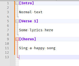

      If there any language that only uses the [ ] square brackets. I will need for ai-music “programming”.
      Example like this
      [Intro]
      [Verse 1]
      [Chorus]
      And then I write the textlines under the [name]. Pretty simple codes so is there a language to use. I have try a lot but not finding any that works for this
      tia
      Thomas
        PeterJones @IronWalkers
        @IronWalkers ,
        Language > I > INI file
        Though if you have any = in the “textlines under the [name]”, the = will be red and the text to the left will be blue italics (in the default styerls.xml theme; your selected/customized theme may use different colors):
        If you don’t like the = behavior , then you could define a simple UDL instead of using the built-in INI language: in Language > User Defined Language > Define your language, create a new language (named AI Music or something); leave most as the default settings, but on the Operators & Delimiters page, for Delimiter 1 style, set Open = [ and Close = ], and set the Styler to your preferred color (bold and purple to match INI, or whatever you want).
