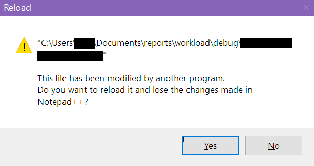

      I have a file that I am working on in two programs. Notepad++, PL/SQL Developer.
      In Notepad++ I’m close to the bottom of the file, and in PLSQL Developer I’m somewhere at the top
      After making a change in an external program and saving the file, notepad++ asks me
      So I save some changes in an external program.
      When I go back to Notepad++, it asks me if i want to reload the file. I can choose not to, but I would prefer to be asked to merge my changes and approve or deny…
