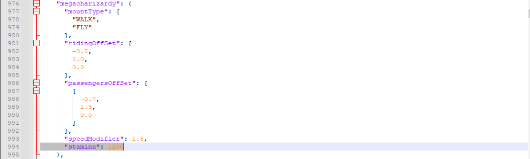

      Hello, im completely new to NotePad++, and i need help figuring out how to change this all at once. i dont want to sit here and do it all individually lol.
      im using a minecraft mod config file and i want to change all the, for example,
      “stamina”: 1200
      to
      “stamina”: 9999
      or,
      “speedModifier”: 1.5,
      to
      “speedModifier”: 2,
      all of the “speedModifier” tokens (I think thats what theyre called) to 2, and all the “stamina” to 9999.
      heres an example snip.
      Help please!!

        You have to enable “Regular expression” in Replace and you will add
        Find what: "stamina":\s*\d+
        Replace with: "stamina": 9999
        Find what: "speedModifier":\s*\d+(\.\d+)?
        Replace with: "speedModifier": 2
        You can do each replacement separately, or manage all replacements in a list using the MultiReplace plugin.

            You might also be able to achieve this with the query
            @..stamina = 9999;
            @..speedModifier = 2
            in the JsonTools plugin.
            In this case a regex-based solution as described by Thomas Knoefel will work fine, but if you want more control over how you manipulate your JSON, a JSON parser like JsonTools is likely a better option.
