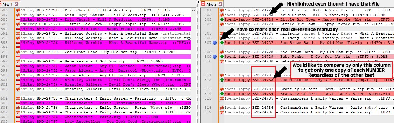

      Hey Everyone,
      I suck at this so please bare with me.
      I am trying to compare two notepad files. They are essentially lists of files I have.
      I can successfully compare them (woohoo)…
      Here is an example of a few lines for better understanding
      !MrRay BKD-24787 - Maren Morris - Drunk Girls Don’t Cry.zip
      !MrRay BKD-24789 - Bruno Mars - That’s What I Like.zip
      !MrRay BKD-24791 - Brett Young - Sleep Without You.zip
      !MrRay BKD-24793 - Chris Janson - Power Of Positive Drinkin’.zip
      !MrRay BKD-24795 - Drake - Passionfruit.zip
      !MrRay BKD-24797 - Drake White - Makin’ Me Look Good Again.zip
      !MrRay BKD-24799 - Brothers Osborne - It Ain’t My Fault.zip
      !MrRay BKD-24801 - Florida Georgia Line - Dig Your Roots.zip
      in a perfect world I would love to be able to compare by columns…
      I have “show only diffs” checked off but it returns the while list with differences highlighted. which requires me to mark each difference by hand
      700k lines compared and thousands of results need to be C&P
      in addition…
      Right now it highlights some only because the spelling is different or there are a few extra characters in the titles.
      I would love to have the program compare what i would call the second column
      (BKD-xxxxx) and only show me the differences (ones missing) so I could C&P them into another notepad file.
      Is there a way to accomplish what I am looking for? or is it beyond what notepad++ and COMPARE plug-in is capable of?
      1st image attached is what I get after I compare
      2nd is what I am looking for

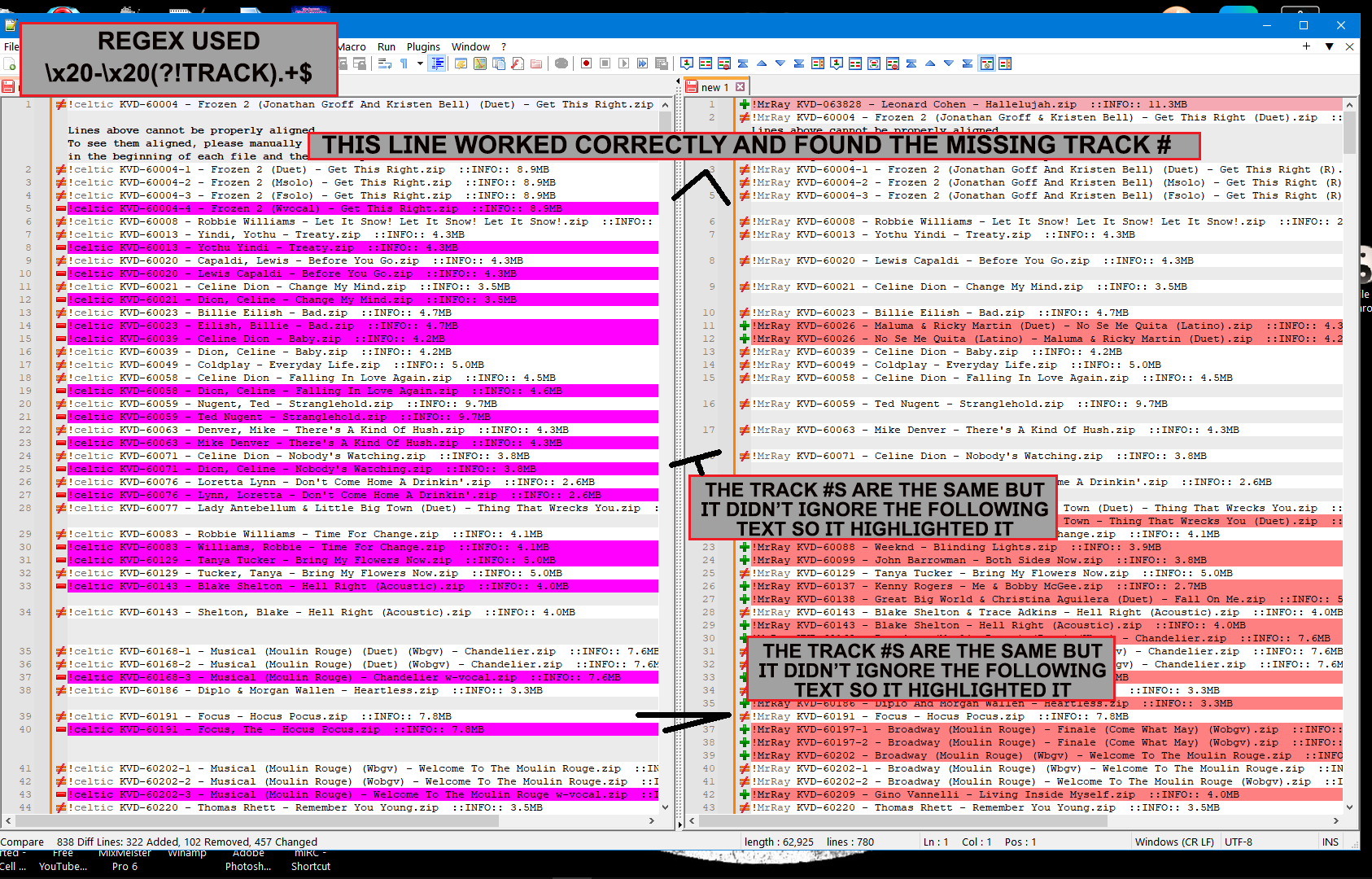

                      example SC1000-15 - Frank Sinatra - My Way.zip
                      The last code you offered seems to work well…
                      It returned the tracks I was missing compared to the other listby highlighting them
                      for some reason even with “return only diffs” checked off it still only highlighted the diffs…it didn’t just list the differences …but I can live with that…
                      it basically decides what to show me by simply the differences in the “disc and track#s” and ignores any differences in the “Artist and Title”…so THATS GREAT
                      I then bookmark the ones I need manually, clear all non-bookmarked lines and I have a nice list to C&P for my next step of acquiring them from the other persons library…
                      you have made this process easier and THANK YOU…

                          GUY: thank you again for your help… The second code you shared seems to be ignoring the person the list is from…that worked
                          However since I wasn’t specific in explaining that the disk and track could be other than always being BKD I think it is not ignoring the other text after the DISC-TRACK#
                          Here is a screen shot of what I get when I use a list from another person and discs/tracks other than BKD with the same regex code
                          I don’t want to be a bother or pain in the butt so I will use what I have and no hard feelings…

                            Hi, @ray-landolfi, @coises, @alan-kilborn and All,
                            @ray-landolfi, while seeing your picture, I note that the ComparePlus plugin tell you to add a new empty line at the very beginning of your two files in order to compare them properly. So :
                            • First, follow this advice and add an empty line on top of each file
                            • Secondly, change the Ignore regex and use this new one ^.+?\x20|\x20-\x20.+$
                            • Thirdly, re-compare your two files
                            This time, everything should be OK !
                            For your information :
                            • Copy the three lines below, provided in your last post, in a new tab
                            !celtic KVD-59990 - Luther Vandross - Killing Me Softly.zip  ::INFO:: 2.6Mb
                            !beni-Lappy BKD-24733 - Brantley Gilbert - Devil Don’t Sleep.zip
                            !MrRay SC7515-12 - Frank Sinatra - My Way.zip
                            • Open the Mark dialog of N++ ( Ctrl + M )
                            • Type in the regex ^.+?\x20|\x20-\x20.+$ in the Find what: zone
                            • Un-check all the box options ( IMPORTANT )
                            • Check only the Wrap around option
                            => All text should be highlighted, except for the zones KBD-59990 , BKD-24733 and SC7515-12
                            So, the highlighted zones are the zones excluded of the comparison by the ComparePlus plugin. Thus, ONLY the parts KBD-59990 , BKD-24733 and SC7515-12 will be taken in account in the comparison process !
                            Now :
                            • Open a real file of yours
                            • Repeat the above MARK operation
                            => You’ll can verify that everything, but the DISK-TRACK zones, is marked, as you expected to !

                            • ray LandolfiR Offline
                              ray Landolfi @guy038
                              @guy038
                              I havent tried to sort files in a while and finally came back to check your responses…
                              Yes that latest regex worked to isolate just the files that were missing solely by the track info… Thank you again…
                              The added info on marking all those returned files at once however didn’t work… I only resumed the process today and have been marking them by hand… I tried to select all and copy the lines but it copies every line not just the compared lines so its back to individually marking them… it’s not fun but it beats looking through tens of thousands one at a time…
                              Thanks again for all your help…
