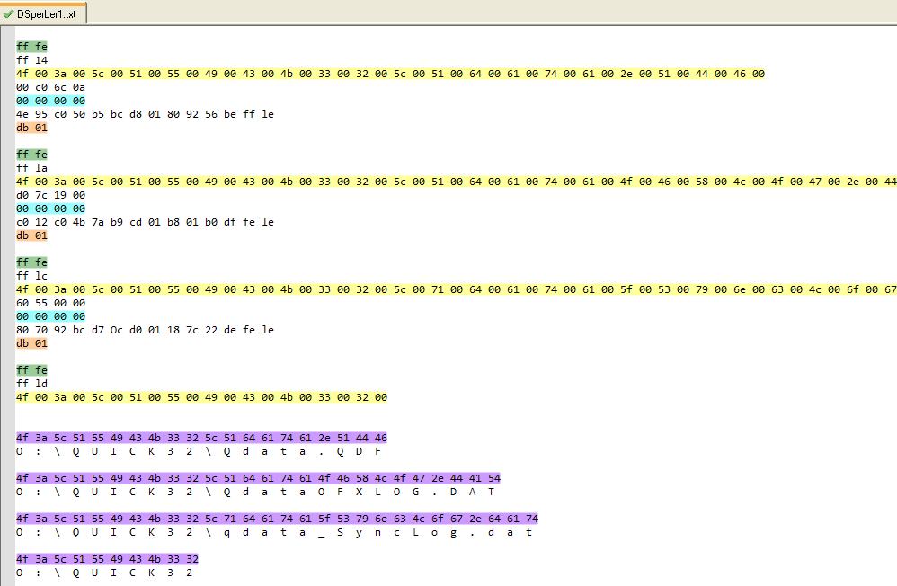

                Hello, @DSperber1, @mark-olson, @mkupper and All,
                @@DSperber1, I’m pleased that you’ve got the right program ( mrcdat2txt.exe ) to edit your .mrcdat log files :-))
                Now, before your last reply, I tried to guess the similarities between some parts of your .mrcdat file and, indeed, I’ve found some !
                As you can see on the picture below :
                • Each row of your table seems to begin with the FFFE sequence
                • Each row of your table seems to end with the db01 sequence
                • A four zero-byte sequence occurs in middle of each section
                • The Yellow sequence looks like a valid UTF 16 LE BOM sequence of characters. Thus, to my mind, I thought to get valid strings after suppression of all zero bytes, in these lines …
                … And bingo ! You can verify that each Mauve/Pale Violet line, below, correspond to the File Name part of each line of your table !
