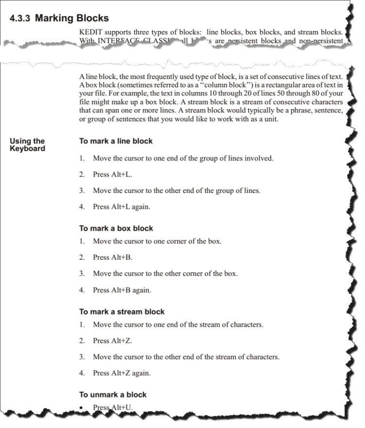

      I’m trying to replace my text editor (Kedit). This old text editor (legacy mainframe editor was the Xedit) has selective editing. After several updates I’m wondering if NPP now has selective box editing.
      I’m trying to import raw text data. I know npp can copy or move columnar data. But can I edit data in a box using npp (see below) ie. also fill a box with blank spaces or do calculations on a column of numbers. Thank you.

        @bofhlusr said in Does NPP have selective box editing?:
        Yes
        Depends on what you mean… pasting sections of some other application’s user manual won’t be overly helpful, because we might not understand the context you are using them in.
        If you had a column selection of blank spaces the right size, you can paste over your new column selection. Or if you have N spaces copied, and have a column selection N wide and M tall, doing the paste will overwrite all M lines of the block with the clipboard; or if you had the NxM selected and then typed N spaces, it would replace those with N…
        Notepad++ search/replace doesn’t do math. See our Mathematical Replacement FAQ
        update: Looking again at the screenshot (which I admit I didn’t read at first)
        • DELETE A BLOCK = use the DEL or BACKSPACE key
        • Upper/Lowercase = Edit > Convert Case To… works on column/block or on stream selections
        • Shift left/right = depending on what is meant by shift, you can click-and-drag on the block after making the column selection to drag it left or right.
        • fill a block = not without scripting, though I think doing it in PythonScript wouldn’t be too hard (never tried)
        • overlay = copy the block then paste at new location (might need to do a block selection for the new location as well, depending on the exact situation)
        • unmark a block = to exit column-selection mode, hit ESC
