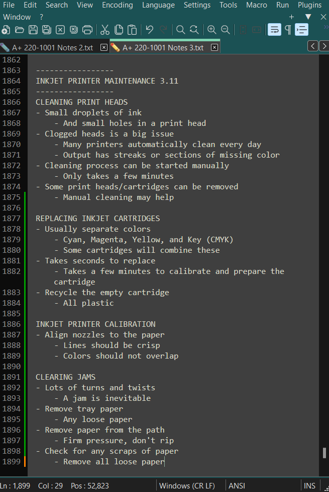

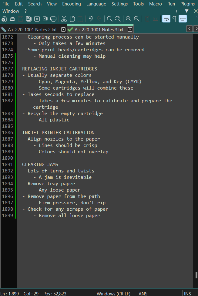

    Is there a way to keep a blank "working space" as I'm logging information?

        @PeterJones Thanks! I installed the PythonScript plugin and created the script based off your code, but I still can’t seem to get it working with my document. Also, yes, I do have the “Enable Scrolling Beyond Last Line” box ticked, which I should have mentioned is how I was able to take that screenshot.
        How would I go about setting up a callback to use this script in my document? I would rather have it run automatically as opposed to using a keyboard shortcut every so often. All things considered, this is a very minor issue – but I nonetheless appreciate any input!

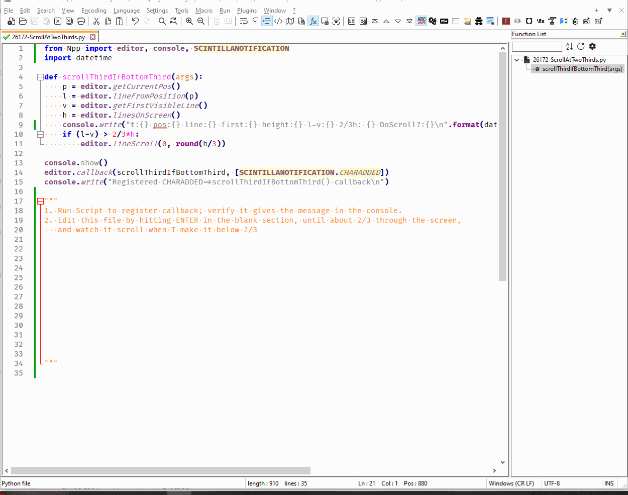

                    PeterJones @Nexus
                    @Nexus said in Is there a way to keep a blank "working space" as I'm logging information?:
                    Unfortunately, this alternative didn’t work with me. I’m not sure if maybe I had made a mistake somewhere, but I still very much appreciate your time and advice!
                    If you can ever spend more time on it, and give feedback as to what did and did not happen (making sure to check things like the PythonScript console to see if there were any errors), here is a debug version of the script, which will print every time you add a char (ie, type something). If you hit ENTER enough in your file that your caret (typing cursor) is over 2/3 of the way down, it scrolls.
                    from Npp import editor, console, SCINTILLANOTIFICATION
                    import datetime
                    def scrollThirdIfBottomThird(args):
                        p = editor.getCurrentPos()
                        l = editor.lineFromPosition(p)
                        v = editor.getFirstVisibleLine()
                        h = editor.linesOnScreen()
                        console.write("t:{} pos:{} line:{} first:{} height:{} l-v:{} 2/3h: {} DoScroll?:{}\n".format(datetime.datetime.now(), p,l,v,h,l-v, 2/3*h, (l-v) > 2/3*h))
                        if (l-v) > 2/3*h:
                            editor.lineScroll(0, round(h/3))
                    console.show()
                    editor.callback(scrollThirdIfBottomThird, [SCINTILLANOTIFICATION.CHARADDED])
                    console.write("Registered CHARADDED=>scrollThirdIfBottomThird() callback\n")
                    If you run this script, the PythonScript console should show up automatically, and it will print a message that it Registered CHARADDED=>scrollThirdIfBottomThird() callback. Then as you add characters (by typing or pasting or what have you), if your caret (typing cursor) is below 2/3 of the screen height, it will show a True and scroll the screen.
                    Here’s an animated screencap showing the steps I use to run the script, and how I prove to myself that it works as I type down to go below about 2/3 of the way (which is ~24 of the 35 lines):
