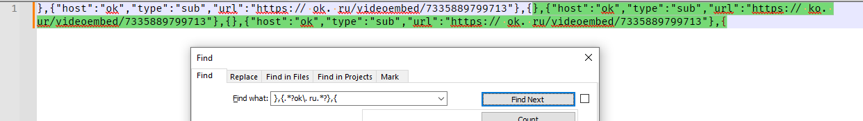

        With the reasonable guess of },{.*?ok\. ru.*?},{ to try to match that sequence that has ok. ru in the middle, it properly matches the first, but the second match is too big, because .?* doesn’t actually restrict it from matching },{ in the middle:
