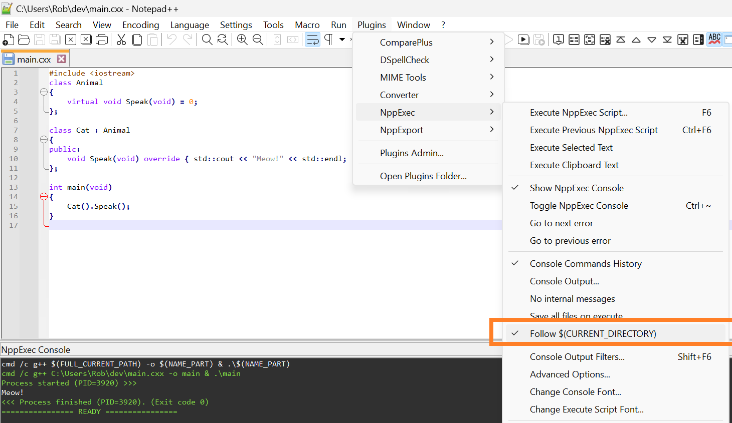

              P.P.S Not to leave out Notepad++, you could also just install the NppExec plugin.
              Assuming your MinGW toolchain is in the PATH, just open the NppExec console and run this:
              cmd /c g++ $(FULL_CURRENT_PATH) -o $(NAME_PART) & .\$(NAME_PART)
                @rdipardo said,
                That assumes that NppExec’s current working directory is the same as the active file. And that the active file’s full current path has no spaces. Both are dangerous assumptions, in my opinion.

                • rdipardoR
                  rdipardo @PeterJones
                  The directory will change automatically after clicking on NppExec’s “Follow $(CURRENT_DIRECTORY)” option (which I thought was enabled by default – sorry):
