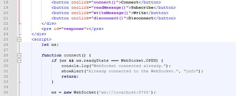

      Here is where the background goes light blue …

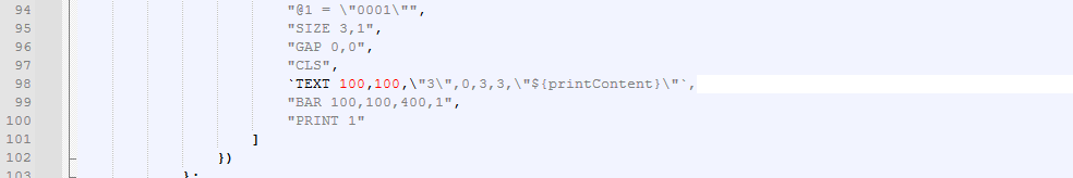

      Then it turns back white after the final comma in a line, but then back to light blue again …

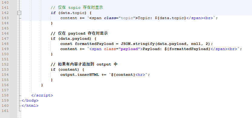

      Finally, the background goes back to white right after the closing paren in “data.topic” and remains white for the rest of the file.

        I would guess that the problem at line 143 is because the character sequence </ is not legal within script tags. That definitely applies to string literals; I couldn’t find a clear statement about template literals, but I suspect it applies there, too.
        I’m not sure exactly what’s happening on line 98, but judging by the coloring there and elsewhere, it looks like the syntax highlighter doesn’t understand template literals at all. That would be a Lexilla problem, I suppose. I could only find one issue that sounded related, though, and that discussion lost me before I got halfway through.

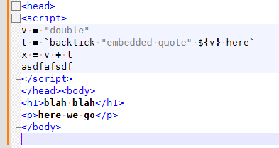

          Using the normal Language > J > JavaScript, it properly recognizes and formats the template literal (the Style Configurator for non-embedded JavaScript calls it the STRING RAW style):
          v = "double"
          t = `backtick "embedded quote" ${v} here`
          x = v + t
          … but if you wrap that in some HTML and use Language > H > HTML,
          <head>
          <script>
          v = "double"
          x = v + t
          asdfafsdf
          </script>
          </head><body>
          <h1>blah blah</h1>
          <p>here we go</p>
          </body>
          then it doesn’t recognize the template literal.
          And yes, if I escape double-quotes inside a template literal, then a parser that doesn’t recognize the template literal will not see that first double-quote as escaped. Pretending to be the LexHTML-based embedded-JS subparser, I think it’s seeing:
          `TEXT 100,100,\"3\",0,3,3,\"${printContent}\"`
          ^ it doesn't seem to recognize the backtick to start the template literal
           ^^^^ it is treating TEXT as a WORD
                ^^^,^^^ it is treating those as numbers
                        ^ it is not using this to escape a character, because it doesn't realize it's in a string
                         ^ this is the start of a what it thinks is a "string"
                           ^^       ^^               ^^ these three are all being treated by the parser as part of the "-string
          … but it seems to be ending the string at the end of line, because the "BAR 100,100... line is correctly interpreted as a full start-and-end-of-string.
