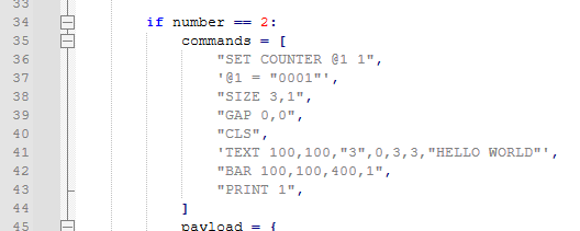

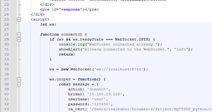

      In both .HTML and .PY files, and presumably others, strings are displayed in a light grey color that is very hard to read on some displays. I’d like to change to a different color, but I cannot find the correct setting in Settings / Style Configurator. I’ve read the help, and looked everywhere that seems sensible to me, but there is no String type I can find.
      I uninstalled NP++ and re-installed it with no change in behavior.
      Here are two screengrabs that illustrate.
      First, a .HTML file:
      Second, a .PY file:

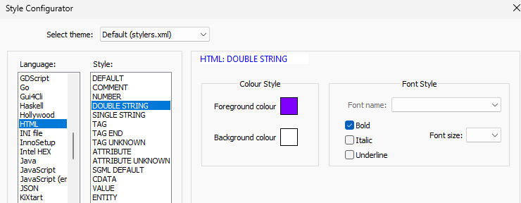

        Style Configurator > HTML > DOUBLE STRING or SINGLE STRING for "double" or 'single'
        But what you show is actually a javascript string, not an HTML string. That is in the Style Configurator > Javascript (embedded), with "DOUBLE STRING" or 'SINGLE STRING' as the styles you want to change.

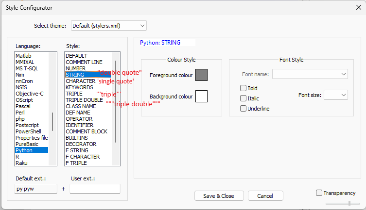

        Style Configurator > Python
        • "STRING"
        • 'CHARACTER'
        • '''TRIPLE'''
        • """TRIPLE DOUBLE"""
        • and the F-variants lower down for python3 f-strings
