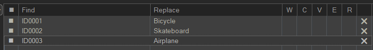

          You can achieve this with the MultiReplace Plugin, but for simplicity, I recommend splitting the replacement tasks into different languages.
          To do this, create a replacement list in the MultiReplace Plugin that looks like this:
          You can also generate the Replacement list as it is stored in CSV format.
