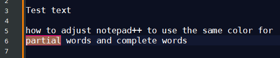

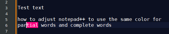

      For easier finding search-hits I changed the color for selected text to pink.
      Here are screenshots how it looks like
      a partial word is highlighted in pink as I want it
      Now If a complete word is marked the color changes to some light brown with pink border huh?
      Where do I have to adjust what color-option to have it marked always in pink
      I want to use pink for easier finding searched text and I want the highlighted text to be pink always regardless if it is a partial word or a complete word.

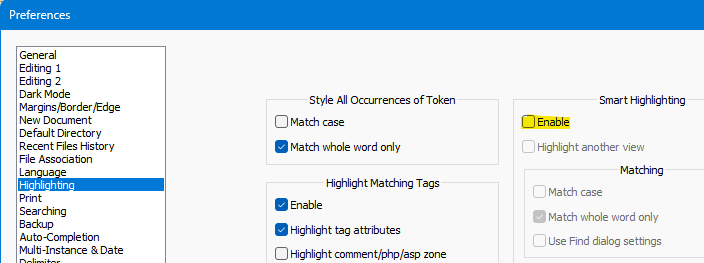

        Alan Kilborn @Billy Gates
        @Billy-Gates
        It’s likely that the Smart Highlighting feature is causing the effect you see; as a first step try turning it off completely. Go to the Settings menu and choose Preferences…, and then uncheckmark this box:
        Then test things out…
        Billy GatesB 1 Reply Last reply Reply Quote 3
        • Billy GatesB
          Billy Gates @Alan Kilborn
          Hi @Alan-Kilborn
          yes that works!
          Thank you very much!
