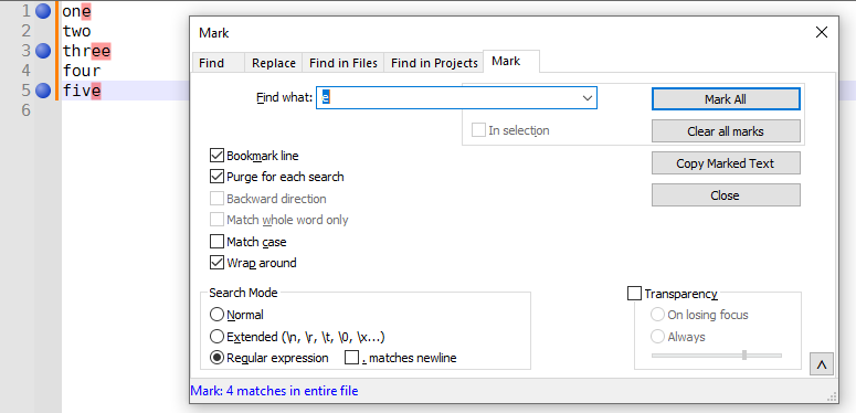

          In order to be able to do things with the lines of marked text, when you use the Mark dialog, you need to remember to checkmark ☑ Bookmark line as well.
          Then you can do the search to add the marks (highlights) and bookmarks (circles). Then use the Search > Bookmark > … commands (*) to delete the bookmarked or unbookmarked lines. (*: or right-click on the bookmark margin to access the same menu of commands)

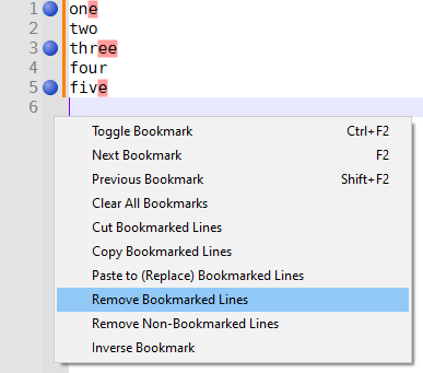

          If I have a file with the words one to five on separate lines, and want to delete only the lines that contain the e character, I could:
          1. Mark and Bookmark those lines
          2. Use the Bookmark menu to Remove the Bookmarked Lines
          3. End up with only the non-matching lines:
          Using the Remove Non-Bookmarked Lines would do the opposite, deleting two and four and leaving the other three words.
