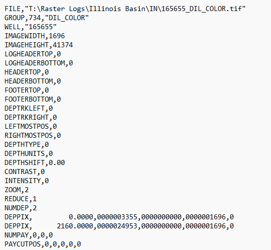

      Hi,
      I am sure this has been covered, in one way or another, but the searches come up with very code heavy solution that leave me clueless, and I have zero idea what i am doing.
      I am trying to edit a few thousand files like the below. The Value WELL,“XXXXXX” is unique to each file, and I want to use a reference table to replace that unique 6 digit identifier with a 14 digit unique identifier. Can the find in files and replace function do this?
