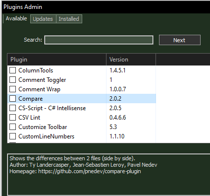

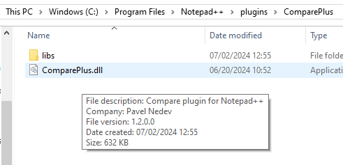

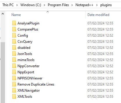

      I’m unable to install the ComparePlus plugin on my work computer via Plugins Admin due to GitHub not being available via the network. So I have downloaded the latest version on my personal computer, and have transferred it to my work computer, C:\Program Files\Notepad++\plugins\ComparePlus. Also due to the lockdown of my work computer I have to get a computer admin to install, or copy, the files to the above location.

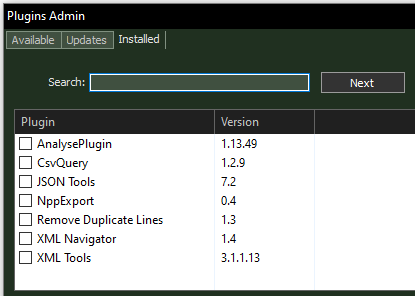

      After copying the files to the location, I opened, but only some of the plugins I copied show up in the program, see screenshots, 7 of 11. Some of those could be due to being incompatible with the 8.4.2 version of NPP, but the ComparePlus readme says that ComparePlus plugin is available for Notepad++ versions above v8.4.2 (included). And the release notes for v1.0.0 say Improved integration with Notepad++ (works only with Notepad++ versions >= 8.4.2).
      So everything I’m seeing, this plugin should work on my work computer with the only available 64bit NPP version approved to be installed, but as you can see from the screenshots it is not.

          The ComparePlus plugin has three DLLs. You should check the Mark of the web thing @PeterJones mentioned on all three files. Here’s what I see for the files:
