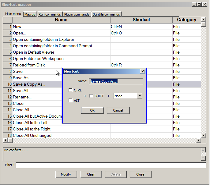

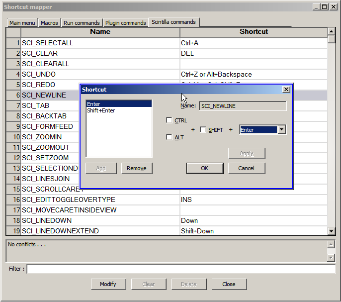

      Are there specific use cases for the Shortcut mapper to have 2 sub and slightly different sub-dialogs as shown in the following screenshots?
      Available for Scintilla commands tab only
      Available for all other tabs

      • 2 sub dialog? Wouldn’t be better none sub-dialog but doing the mapping in the Shortcut mapper dialog it self?
      • Using the sub-dialog Shortcut is tedous since for each mapping action there are too many single actions to do
        -> Open the main dialog
        -> Find the command to map a shortcut to
        -> Open the sub-dialog
        -> Search for a shortcut that doesn’t overlap with an existing one
        -> Confirming
        -> Repeat from 2nd step

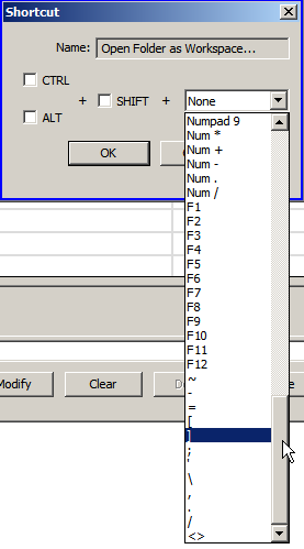

      • The drop-down menu
        containing the list of possible normal and special chars/keys seems to have a limited list of them and in some phisycal keyboard layouts do not contain some of the chars in the drop-down, and some others: for example the tilde symbol and some others cannot be used since to use them it is necessary to get them by typing the relative ASCII or Unicode char-code number: and that makes problematic to use a shortcut that contains those chars. This, potentially, limits the number of possible combinations.
        Other keyboard layouts there are other chars that could be used easily because are accessible but they are not present in the mentioned drop-down list.
        I suppose some of the above aspects are due to internationalization/localization needs but I am not sure

        @wonkawilly Notepad++ only allows now shortcut for Notepad++ actions. It allows more than one shortcut for Scintilla actions. If you edit the shortcuts.xml file manually you will discover that attempting to rig things up so that two shortcuts point at the same Notepad++ will not work. You will get the shortcut that appears first in shortcuts.xml and the other one is ignored.
        I have never dug into the Notepad++ code to discover why this restriction exists. One reason I can guess at is that when drop down menus are displayed they also show the shortcut, if any that can be used for that action. If more than one shortcut was allowed for an action then that code at minimum would need to be cleaned up.
        I agree with you though that it’s confusing that the Scintilla actions in the shortcut mapper’s GUI have a slightly different dialog box and behavior.
          Since you don’t seem to be aware of this, we have a FAQ which explains what each of those keycodes maps to on different (international) keyboards. For example, on a standard French keyboard, the ~ shortcut is accessed using the ù % key, because that’s the VK_OEM_3.
          In @guy038’s section of that FAQ, it lists the scancode, the US keyboard equivalent, and the French keyboard equivalent. Other sections of the FAQ include the standard German and Portuguese mappings, and my post in that FAQ links to a website that allows you to figure out which keys on your keyboard map to which virtual keys – so if you have a keyboard not listed there, feel free to make a table like the German or Portuguese tables shown, and I can add it to the FAQ so that other users of your keyboard layout will have access.
