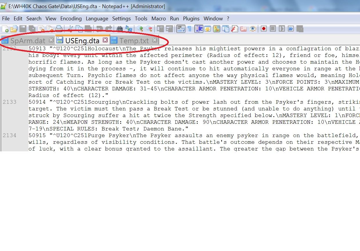

                  Here’s for a screenshot. It’s not a mean issue. Just the sudden change in size and (bold) composition of the tabs’ style. I never saw that, since I never touched that kind of option. But browsing through the “Preferences” or “Style configurator” menus doesn’t help for now. Did I miss something ?
                  CoisesC PeterJonesP 2 Replies Last reply Reply Quote 0

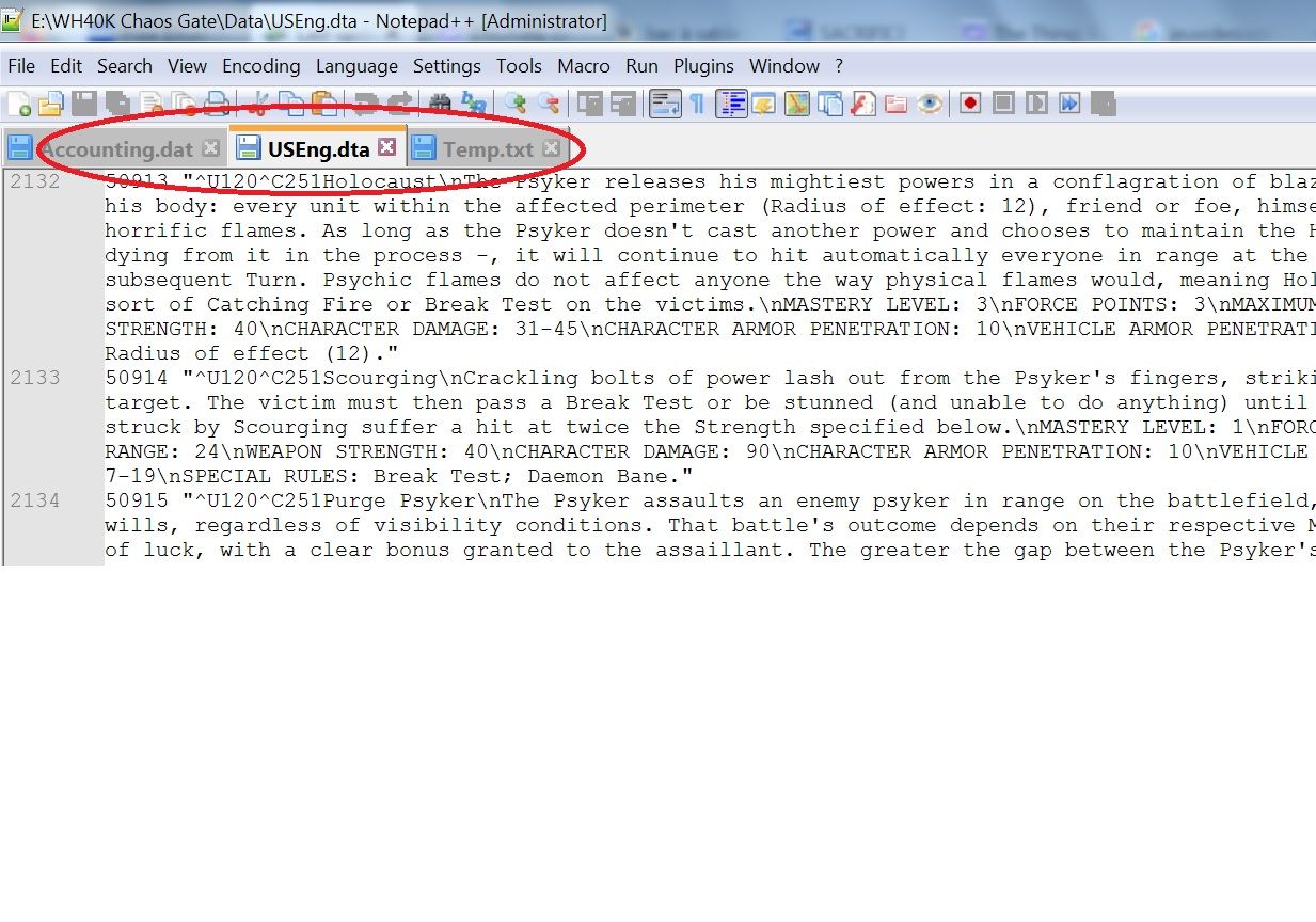

                        Okay… Settings > Preferences > General > Tab Bar > Reduce did have an unexpected impact.
                        The tab labels actually use a smaller font with the “Reduce” option unchecked !
                        But it’s still composed using a Bold style. I really don’t understand why, but I’ll tell you what : I could live with that ^^.
                        I also experimented with %AppData%\Notepad++ and Administrator mode - which was checked, indeed, because of protected files : I use that a lot. But no dice… Recreating a new folder didn’t change anything.
                        Thanks a lot for trying to help ! As said above, I could honestly live with tabs in Bold, now that I can at least read longer labels ^^… It’s just a weird issue.
