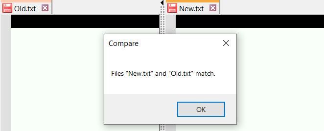

      When I get a perfect match using ComparePlus, it hides text with all-black paint. All ComparePlus settings are default, including color settings. Is this how it works or is something wrong?

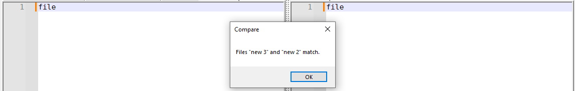

        Not for me:

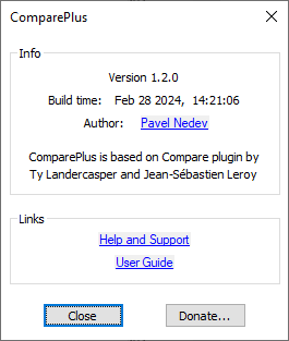

        Which version of ComparePlus are you using? Mine is 1.2.0:

          Thank you for your reply. I’m using the same version as yours. I’m not sure about stylers.xml.

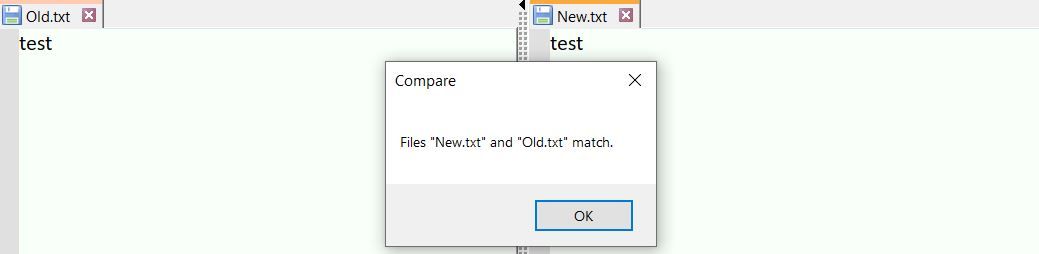

                  I found that what seems to always happen is the diff feature works with the first attempt. And it works even after editing the files as far as the both files are not identical. But when I either click “Clear Active Compare” or edit the file to make the text identical on both files, it gets black. I’ll need to close those files and reopen them to make it work again.
