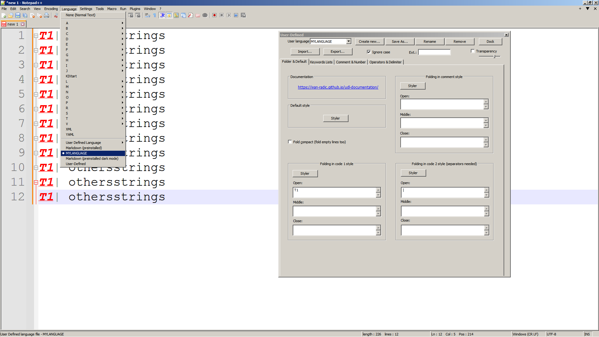

            For grouping I am not able to help but to define the first language you could follow the following indications:
            How to:
            • open Menu > Language > User Defined Languages > Define Your Language Dialog
            • Give the new language the custom name you like
            • than in “Open” under folding in code 1 style “T1”
            • click on the Styler button
            • and from the dialog that shows up, choose your Foreground color (or the Background one if it better matches your needs)
            • Than confirm clicking on ok btn
            • Now type the pipe symbol into “Open” under Folding in code 2 Style
              and repeat the rest of the steps to give the needed color
            You are ready. Now close the dialog (not mandatory) and then just click on the menu > Languages > TheNameYougaveToYurNewStyle
            A screenshot follows with the result:

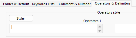

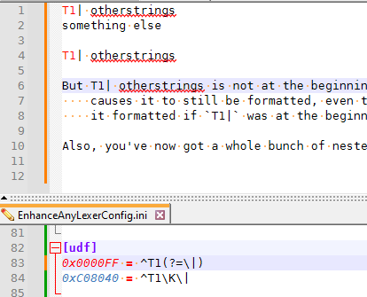

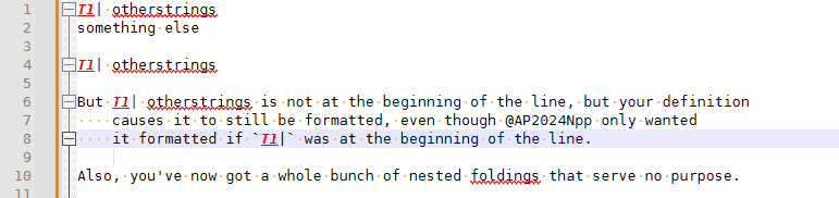

              PeterJones @wonkawilly
              @wonkawilly ,

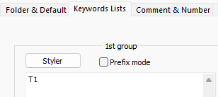

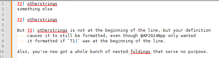

              It should be noted that @AP2024Npp’s phrasing implied they wanted T1| formatted only if it’s at the beginning of the line. Your suggestion of using Folding In Code will cause it to format even later in the line, as shown in this screenshot.
              Further, by using the “Folding in Code” settings, it introduces the folding, which wasn’t part of the original request. Also, because there is no “close” setting, it means that folding one of those will fold everything that comes after, to the end of the file.
              If all you wanted was red T1 and blue/gray |, and you didn’t care where those went, you could use actual Keyword and Operator styling, rather than using the Fold In Code, as those are the styles that are meant for such things. This gets the same results as yours, without the folding:
              23cffbe3-3b3d-4857-a3cf-edc32951ad8f-image.png e7845145-a0c8-467f-a786-59ec693285ab-image.png 62aa44bc-ff0c-4593-8a0e-dac56d8370b1-image.png
              But I don’t think it meets the original request, which is why I suggested EnhanceAnyLexer plugin, because that can ensure that the T1| happens at the beginning of the line, but not elsewhere:
              (my example was with the default “Define Your Language” without naming it… if you had named it, it would have come up with [NameOfUDL] instead of [udf] for the .ini-section-header.

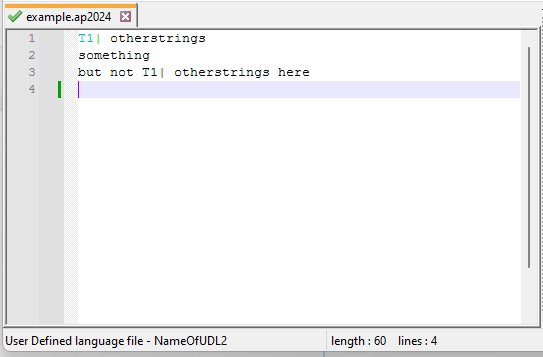

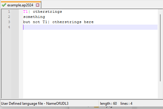

                    So, if you have three separate languages that you’ll want to apply for your use-case, you will need to create three different UDLs (User Defined Languages) – I’ll call them NameOfUDL1, NameOfUDL2, and NameOfUDL3. Then you will have to Enhance Current Language once for each of those (or do it once, and copy/paste into three different sections in EnhanceAnyLexer.ini, making sure to have the correct name of each section. Then the next time you activate one of NameOfUDL1, NameOfUDL2, or NameOfUDL3 for a given file, it will apply the enhancements defined for the chosen UDL.

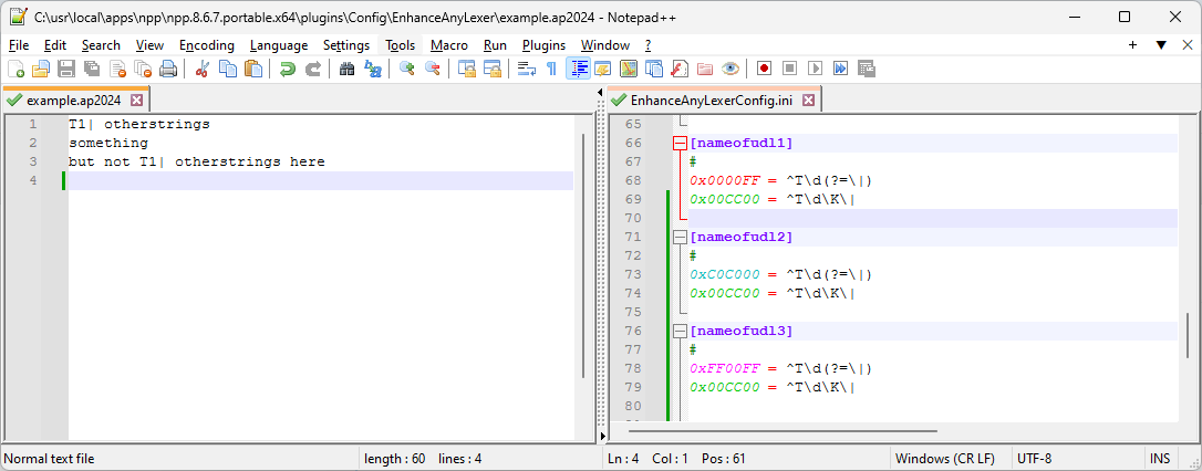

                    Here’s an example:
                    file:
                    T1| otherstrings
                    something
                    but not T1| otherstrings here
                    Excerpt from Languages menu:
                    Excerpt from EnhanceAnyLexer.ini:
                    [nameofudl1]
                    0x0000FF = ^T\d(?=\|)
                    0x00CC00 = ^T\d\K\|
                    [nameofudl2]
                    0xC0C000 = ^T\d(?=\|)
                    0x00CC00 = ^T\d\K\|
                    [nameofudl3]
                    0xFF00FF = ^T\d(?=\|)
                    0x00CC00 = ^T\d\K\|
                    For this simple example, they are highlighting the same regex, but with different colors, just so you can see it is applied. All I had to do to change which EnhanceAnyLexer config was active was change the selection in the Language menu.

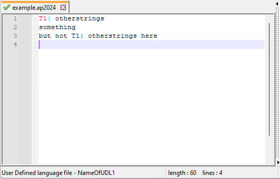

                    Here are screenshots with four different Language menu entries selected:
                    Selected Language Screenshot
