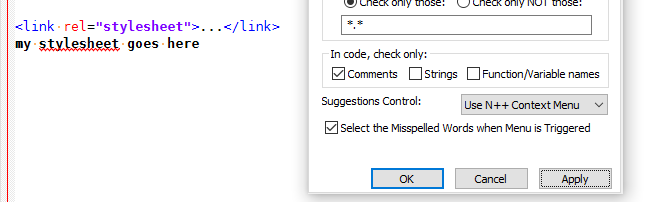

        In a line beginning <link rel=“stylesheet”, it flags the word “stylesheet” as misspelled, even though in the DSPellCheck settings I checked the boxes to check only comments and strings in code. As you know, the word “stylesheet” is an HTML standard.

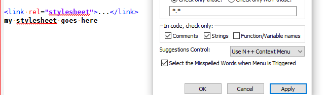

        In most programming languages, a “string” is something within single or double quotes. rel="stylesheet" sure looks like stylesheet is in a string. And if I toggle that setting and Apply it, I get the results I expect:
        vs
        … that is, if the “Strings” option is on, then it checks spelling on attribute values; when “Strings” setting is off, then it ignores unknown words in attributes. However, whichever setting for that, it still properly spellchecks the content of the hypertext (<tag attribute="value">content content content</tag>)
        If you don’t want it to spell check HTML attributes, then tell it to not spellcheck strings.

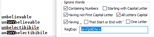

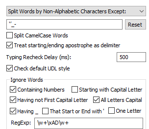

        But while waiting for that to be implemented, you might try a workaround using the Plugins > DSpellCheck > Settings > Advanced: Copy the soft hyphen character, and paste it into the “Split words by non-alphabetic characters except” entry field, so that it treats words with a soft-hyphen as a single-word instead of splitting it into multiple. Then add a RegExp in the “Ignore Words” section – I tried \w+\xAD\w+ (one or more word characters, the soft hyphen, then one or more word characters): that makes it completely ignore words that have the embedded soft-hyphen
        But since it completely ignores them, it won’t spell-check them at all: 4e2ece2f-4759-4b8e-901e-a0af7ab277d7-image.png
        … that’s why I suggest you put in a request for it to pretend soft-hyphens aren’t there, because they shouldn’t be considered part of the spelling of a word.

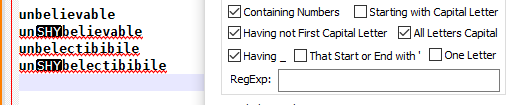

        On those same words, if you have the soft-hyphen in the “exception” list, but don’t define a RegExp, then it treats the soft-hyphen-containing as a single word, but it doesn’t have words with that character in its dictionary, so it calls “unbelieveable” misspelled when it has the soft-hyphen: 0a6527b5-e117-46d0-ab26-d0ee81846533-image.png
