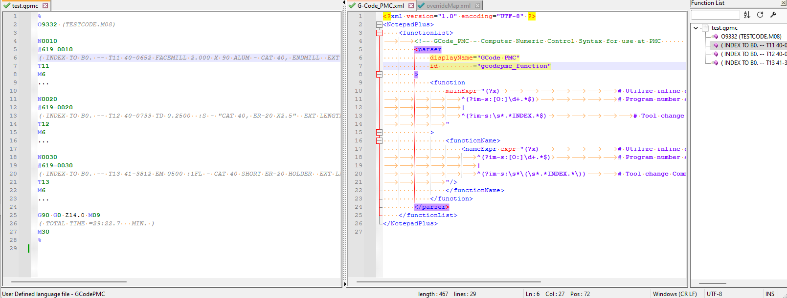

        PeterJones @Grether2000
        @Grether2000,
        I pared it back to bare-bones, then slowly built it up close to yours
        <NotepadPlus>
            <functionList>
        		<!-- GCode_PMC - Computer Numeric Control Syntax for use at PMC                              -->
                <parser
                    displayName="GCode PMC"
                    id         ="gcodepmc_function"
                    <function
                        mainExpr="(?x)								# Utilize inline comments (see `RegEx - Pattern Modifiers`)
        					^(?im-s:[O:]\d+.*$)						# Program number and comment
        					^(?im-s:\s*.*INDEX.*$)						# Tool change Comment line
                        <functionName>
                            <nameExpr expr="(?x)					# Utilize inline comments (see `RegEx - Pattern Modifiers`)
        						^(?im-s:\s*\(\s*.*INDEX.*\))		# Tool change Comment line
                        </functionName>
                    </function>
                </parser>
            </functionList>
        </NotepadPlus>
        One problem was your comment inside the <parser ...<!-- ... --> ... > – XML does not allow a comment nested inside the brackets of a tag like that…
        There was something subtle in the regex that didn’t let it work as-is (at least for me), so I got it to a functioning point starting from scratch and slowly adding similar features.
        And I’ve never tried a function without a functionName, so I put that in without ever trying without it.
        G 1 Reply Last reply Reply Quote 4

          • G
            Grether2000 @PeterJones
            @PeterJones THANK YOU!
            This solved the problem.
            I wasn’t sure it was even working for a while, that was causing me to pull my hair out looking for the cause. After all it was just a stupid mistake with not removing parts I didn’t need.
            Now that I have it working I can make any adjustments to the regex. I’ll need to add some other matches for other machines and their comment formats.
            @guy038 Thank you as well.
            Yes the O or : are valid.
            Your examples give me a few suggestions on ways to improve this for how the code can get created, or saved after use. These are actually comments, and not functions. But it is how we document and organize the code by the tooling used.
