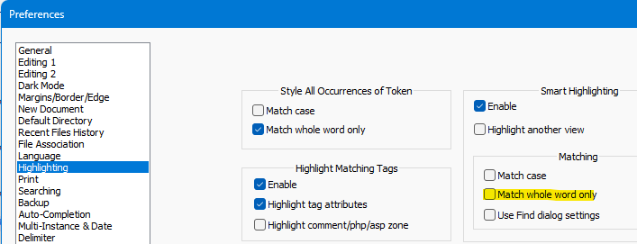

      If I select the same Unicode characters, they will not be highlighted like other words. How to solve this problem?
        Alan Kilborn @moninahh
        @moninahh
        Make sure this setting is set as I show it here:
        M 1 Reply Last reply Reply Quote 0
        • M
          moninahh @Alan Kilborn
          @Alan-Kilborn said in Identical Unicode characters are not highlighted when selected:
          @moninahh
          Thank you very much! It worked!

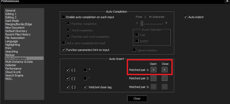

          So as not to create a new topic. I would like to ask you one more question. Do you know what you need to do to make these «» quotes work?
            @moninahh said in Identical Unicode characters are not highlighted when selected:
            Go ahead and create a new topic.
