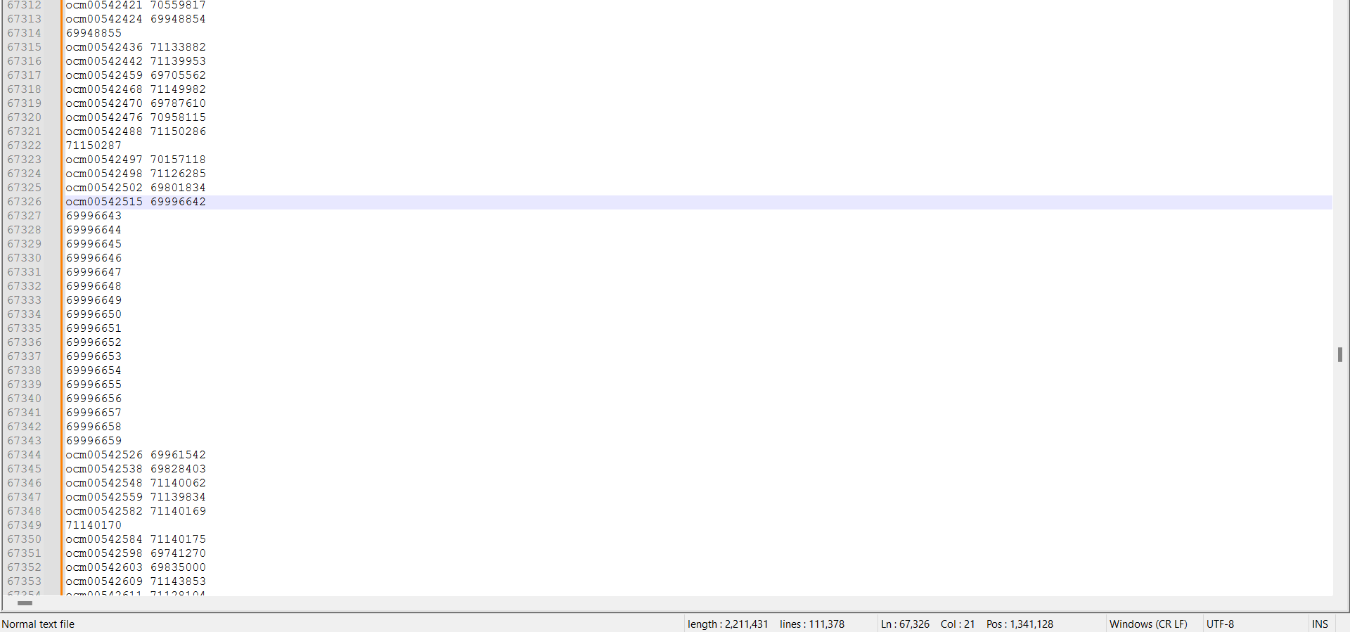

      See attached. This is one example of the many instances this issue occurs in my data set. For ocm00542515, I need all of the associated numbers below it (69996643, 69996644, etc.) to shift to the right column, and then I need “ocm00542515” to be copied and pasted all the way down in the left column until I reach the next “ocm #”. This is a very large data set, and this issue occurs many times throughout, so any way to have this change occur for all instances would be perfect.
        Hello, @sam-keller and All,
        Your goal could certainly be realized easily with a script language , like Python or Lua
        As for me, I think it can be solved with regular expressions, too !
        So, given your INPUT text, below :

        I hope that I correctly interpreted your needs !
        Sam KellerS 1 Reply Last reply Reply Quote 1
        • Sam KellerS
          Sam Keller @guy038
          @guy038 said in How to mass shift and paste (see attached):
          (?1$2 $1:)
          You’re a lifesaver! Thank you so much!
