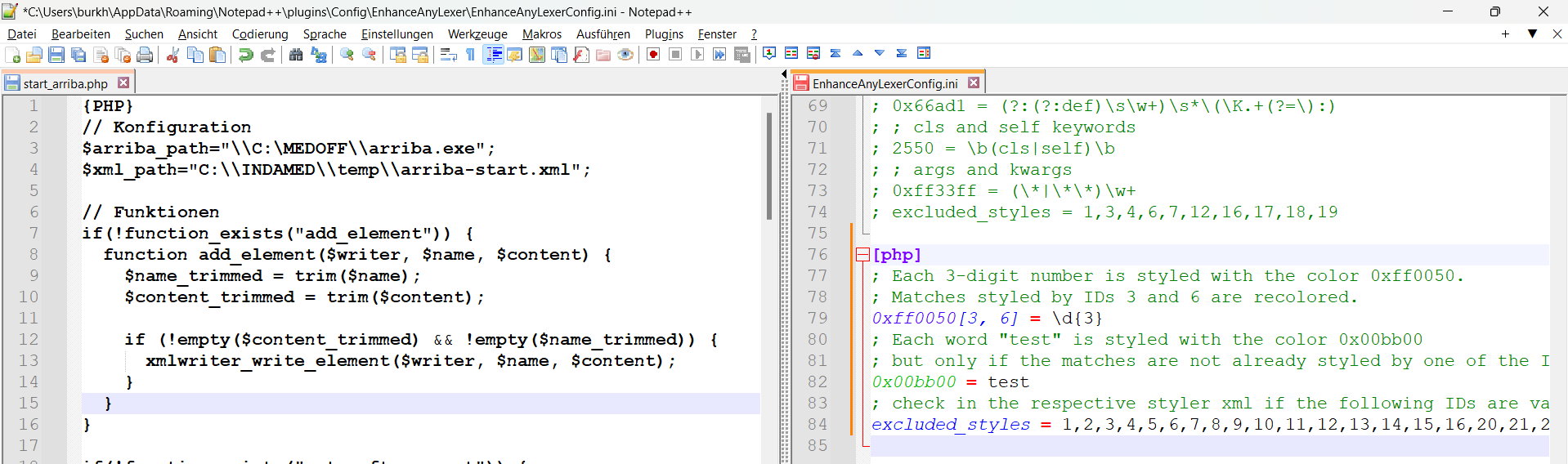

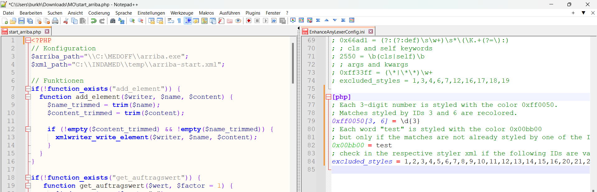

              I installed it. do you know how I can achieve that screenshot 1 will look like screenshot 2
              just coloring it won’t work I’m afraid

                Ekopalypse @sunshinebard
                @sunshinebard
                I’m afraid that doesn’t seem to be possible, as < seems to be a critical part for the php/html/xml lexer.
                It looks like you need to create a UDL yourself.

                  sunshinebard @Ekopalypse
                  @Ekopalypse
                  Thank you for your help! what a pitty. (right now it is easier to just copy the code in between the working <php …)
