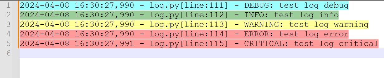

        Can you support parsing and displaying different color strings My log file contains color characters, but it seems that it can only be displayed in the terminal, and plain text can’t be displayed directly, but I noticed that notepad++ has a formatting feature, which I think can be parsed by parsing the corresponding characters or by a related plugin. Here’s what my log says:

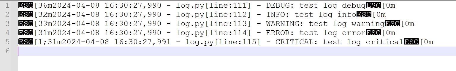

        opens within notepad++ like this:

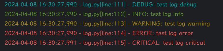

        The reference for what I would like to see displayed within notepad++:

              It looks to me like you want Notepad++ to display your logfile which uses ANSI ESCAPE SEQUENCES in the colors that those ANSI escape sequences define.
              Just so you know, Notepad++ is a text editor with syntax highlighting, it is not a rendering engine. Its goal is to show you the underlying text (or bytes, if they aren’t valid text, like ANSI escape sequences are not). Thus, what you showed with the real Notepad++ is the correct behavior. (This is the same reason Notepad++ shows the raw HTML, not a rendered webpage, when you are editing an HTML file. It is an editor, not a renderer/viewer.)
              However, I do seem to remember that there have been other discussions about this, and there’s either a plugin that does it or someone has shared a PythonScript solution which will interpret those ANSI escape sequences and use Notepad++ syntax highlighting to add in the colors that they define… but I don’t remember exactly, so you might want to search the forum for ANSI escape sequences or similar phrases.
              update: yeah, I think “ANSI escape sequences color rendering” is what I was thinking of. It shows how to use a UDL plus the EnhanceAnyLexer plugin to get it to render colors (but will still show the escape sequences, because that’s how one could edit such a file).
                @PeterJones said in Coloring log files:
                v8.1.1 includes the ErrorList higlighting for .log and .err, which allows ANSI escape sequences higlighting, including recognizing and using the ANSI foreground color escape sequences for choosing the foreground color.
