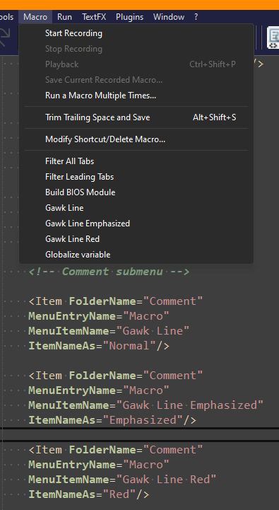

      I’m using the NPP Exec plugin, and I’ve created some scripts that I’ve had it add to the Notepad++ Macro menu. I want to execute those scripts via the context menu; however, I cannot get them to appear on the menu.
      I’ve checked to make sure the names are correct (including case), and I’m not sure what else to try. Here is a look at the Macro Menu overlaying contextMenu.xml showing three of the failing entries:
      I am beginning to think that what I’m trying to do simply isn’t supported, even though the user manual says (emphasis mine):
      “All menu commands can be added to the Context Menu, including plugin commands”.
      So, my question is, can the NPP exec commands added to the Notepad++ Macro menu be executed from the context menu? Thanks to anyone who provides a definite answer.

        Alan Kilborn @Jim Dailey
        @Jim-Dailey said in Macro Menu commands and the Context Menu:
        I’d suggest an addendum to that make it say “All first-level plugin menu commands can be…”. If a plugin has submenus, items on the submenu cannot be added to the context menu.
        I’ve never tried that, but I know if you leave it on the NppExec menu instead of moving it to the Macro menu, you definitely can make a right-click context menu item out of it, with the simple:
        <Item PluginEntryName = "NppExec" PluginCommandItemName = "foo" />
        PeterJonesP Michael VincentM 2 Replies Last reply Reply Quote 2

          @Jim-Dailey,
          Notepad++ still associates those commands with the NppExec plugin, even though they are displayed in the Macros menu. So whether the NppExec commands are left in the NppExec menu or whether they are moved to the Macros menu, they can be referenced using the syntax that @Alan-Kilborn supplied:
          I have about a dozen NppExec scripts in my Macros menu that I reference in my Context Menu that way.

            @Jim-Dailey That (above). I do this all the time. My NppExec scripts are added to the Macro menu and you need to use that syntax to reference them, not MenuEntryName="Macro" - that won’t work.

              Thanks, all.
              I mistakenly thought I had to put the NPP Exec commands on the Macro menu to get to them via the Context Menu.
              I see now that they show on the NPP Exec Menu if I don’t tell it to put them on the Macro Menu. And, as you have pointed out, even if they are on the Macro Menu, the context menu doesn’t “see” them there, but rather on the NPP Exec Menu.
