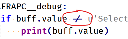

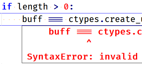

              For readers unfamiliar with “ligatures”, in simple terms it is a visual transmuting of adjacent characters.
              Here are some examples, from typical programming languages:
              • test for equality: without ligature support it would appear ==; with support it looks like this:
              • test for inequality: without ligature support it would appear !=; with support it looks like this:
              • if you put three equal signs together (===), you can get this:
              All the examples I’ve shown use the equal sign in them, but ligatures go way beyond that (using other character combinations).
